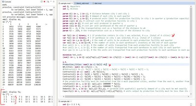

Can someone please tell me what is wrong with my ampl code?

When I run it says:
MINOS 5.51: ignoring integrality of 50 variables
MINOS 5.51: infeasible problem (or bad starting guess).
25 iterations
Nonlin evals: obj = 6, grad = 6, constrs = 6, Jac = 6.
The obj should be 32.3 million. And I should have values of xp in each of the 4 cities where the cost is minimized, here is just selecting the first 4 cities.
Actually it is not that long, it looks so cuz I have posted the data file below in case if someone wants to try to run it.

I can't see where the values for fp(i) are allocated or how you guarentee that only 1 in 6/7 is a 1
Or where the groups of 6 and 7 are specified to the program.

fp is a binary variable since it is a variable, the program should find it out, I can't set values for it in the data. The purpose of it is to select 4 among the 25 cities set in which the cost will be minimized and to use it (when it is equal to one) to find out the production quantities from those four cities xp*fp. The same thing for the three warehouse cities xw and the binary variable fw. There is something wrong though in the programming which makes fp and fw go wrong, however, that is the mathematical programming for such a problem as far as I am concerned.

Forgive my questions, but, sometimes explaining things to others helps to crystalise our own thoughts.
I see that the cities are arranged in ascending order of size, so, there should be a set of constraints like:-
fp(i1) + fp(i2) + fp(i3) + fp(i4) + fp(i5) + fp(i6) + fp(i7) = 1
fp(i8) + fp(i9) + fp(i10) + fp(i11) + fp(i12) + fp(i13) = 1
and the other two
The constraint
Production_Cities: sum{i in c} fp[i] = 4;
Covers "half" the requirement but it's been commented out.

Thank you for your replay, it was helpful. I commented the "=4" constraint temporarily to check where the error is coming from.
Now the binary variable is not working, it is giving me all ones, not only four for some reason.

Sorry: I don't know why CR4 puts such a small limit on the size of images in posts; I can't read any of that. People like Solar Eagle know how to overcome the limit, but, I've never figured it out?
Is the all one problem with or without the constraint?
There are 12½ thousand ways of choosing 4 from 25, and, 1330 ways of choosing 3 from 21. That's nearly 17 million different combinations to try.
You can reduce the 12½ thousand to 1512 if you make it (1in7)x(1in6)3
I don't know how the AMPL optimisation algorithm works but I'm guessing that it would make a lot more difference than {12½ to 1½} if you chose that second scenario.

What you mentioned makes sense. However, I believe all similar mathematical programming optimization problems are relying on the logic that the objective function along with each constraint added will make the feasible area of solutions smaller and smaller. In addition, most good optimization software are able to run as many alternatives.
Re: AMPL
12/01/2019 8:59 PM
So the all 1s problem is with the constraint?
Join Date: Sep 2017
Posts: 17
Re: AMPL
12/02/2019 5:00 AM
Yes. Thank you!
