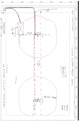

I used the IEEE "Electrician's Guide to Emergency Lighting". This specifies 1 lux min at floor centreline on 2m wide escape routes, with a departure from Euro standard permitting 0.2 lux on unobstructed escape routes for UK.
This clearly divides requirements into escape routes & "open area where escape routes are ill defined such as halls or premises over 60 sq.metre area". An obvious example is where seating means there must be enough light to avoid seats while leaving - open area light is also described as "anti-panic" [shades of current virus Panpanic!]. Lighting for open areas required 0.5 lux minimum at floor, except for 0.5 metre border on perimeter. This is all with zero reflection surfaces, else there would be endless "weasel wording" & dispute about reflections [folk can always paint the wall from white to black later, not knowing why it was white].
An 0.2 lux general open area requirement does not seem very onerous compared to this or other standards mentioned in this thread.
The following picture is what the DIALUX computer program plots for the 86 sq.metre hall with two lamps. The red lines are 2 lux while the green line at the 0.5m border is 0.5 lux, except tiny bits at top corners.
