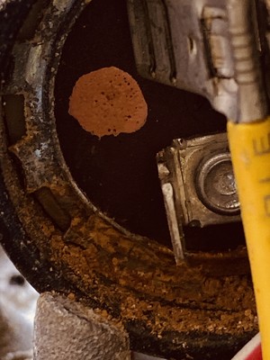

Water well is OUT
Water well runs on 120v
Circuit does NOT trip in Circuit Box
ONLY the Ground Fault Outlet keeps tripping
The Ground Fault outlet IS working ( tested with other device)
As soon as water well plug is inserted it trips the Ground fault
THIS is what the end of the Capacitor looks like... A brown crud like rust but NOT flaky?
Everything else looks good.
Guesses on this situation?

My WAG is that you are looking at the blown vent cap of an electrolytic capacitor. If you are lucky the now dry (no electrolyte) capacitor plates shorted out to the case and tripped the GFCI before other damage occurred. In other words, just replacing the capacitor with an identical value in farads and a voltage value the same or greater can return this motor to operation.

Another view....Still think its the capacitor? Thank you for the input.
Re: Is THIS a Blown Capacitor ????
04/12/2020 12:44 PM
Yes I do. Where's the electrolyte? An electrolytic oil should be inside that vessel. It looks like the failure that popped the vent blew all of the failing electrolyte out, a common failure scenario. Regardless it looks like you need to replace that opened capacitor anyway.
If you are not lucky, a motor winding insulation is breaking down to the case thus still causing a ground fault.

I believe you're right. It looks like a non-polarized electrolytic start capacitor.
A typical motor start capacitor, as can be seen by its black colour and can shape
https://en.wikipedia.org/wiki/Motor_capacitor
The electrolyte (brown rusty looking stuff) is a conductor and when it leaked out could very likely have created the sneak path to ground causing the ground fault interrupter to trip.

I agree it's probably blown. Since it has four terminals, it's probably two capacitors in one case; a starting capacitor and a smaller running capacitor. They are pretty cheap, but make sure you get the correct unit: Same values of capacitance, and the same or a higher voltage rating as the original. If there is a temperature rating given, the replacement should have the same or a higher temperature rating.
Newer capacitors are commonly smaller in physical size than the originals. If that is the case, make sure to use some form of heat-resistant padding, so the capacitor can't vibrate when the motor is running.
When you reassemble the unit, make sure each of the four (or possibly three) wires goes to its correct terminal. Hopefully, you took a photo before disconnecting the wires. If not, study the motor's diagram on the plate. It should identify the correct terminals.

The ground fault essentially measures the difference between the current in the hot side and neutral side. If these are not equal, part of the current is returning to the source via the ground and the ground fault trips. A conduction path to the ground can be either on the hot or neutral side of the pump.
Take the plug for the pump and measure between both the hot and neutral to the ground prong. It should be an open circuit. Check it with the capacitor removed from the circuit. My guess is that the corrosion on the capacitor may be providing a ground path.

First test:Disconnect the pump with only the capacitor connected.(Motor disconnected from cap and circuit).
If it trips, the capacitor is bad,but there may be another issue involved.
Cap Testers do not use a high voltage for testing,so it may be breaking down under line voltage.
Be sure to ground the capacitor to the ground wire of the supply conductor when you remove it from the motor circuit.
Test# 2 If it trips,remove the capacitor from the circuit,and test the circuit with nothing connected at the pump end of the line.
If it trips,there is a nick in the wiring to the pump,or the wiring insulation is breaking down.
I suspect the capacitor is bad.
I have never seen a good capacitor with a leak outside of the case,in over 50 years of electrical work.

After looking more closely at your first picture,you may have had water getting into your capacitor,evidenced by the rusty enclosure.The terminal looks very close to the metal fitting,and there may have been an arc at some time that shorted the capacitor,or there could be a path for leakage current to get to the ground,which will trip a G Fault breaker.
It only requires .005 amps to trip a GFCI, not even enough to create a visible arc.
Sometimes they will trip due to the arching of the plug when inserted into the receptacle.so a good practice is to plug in the load first with the breaker off,then turn on the breaker.
However,I am still betting that the capacitor is bad.
When you replace the capacitor,put a layer of clear silicone caulk around the terminals and the case seal to guard against water damage in the future.
