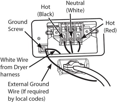

We have an electric clothes dryer, which has a 3-wire configuration (i.e. chassis jumpered to the neutral wire). Unfortunately, the wiring from the breaker panel to the unit does not include a separate ground wire. I would like to convert the 3-wire to a 4-wire configuration, but even if it were possible to run a ground wire it would be cost-prohibitive. Since the dryer is in the vicinity of metal water piping (which is mechanically/ electrically connected to ground), it seems like it would be feasible to duplicate the features of a 4-wire cord and receptacle (i.e. that the neutral and ground would be isolated from each other).
Specifically, would the following steps provide the same safety benefits as those of a 4-wire configuration? Any red flags?
1. Run a ground (e.g. green #10 THHN) wire from the appliance’s ground screw on the terminal block to a ground clamp on an adjacent water pipe.
2. Remove the chassis to neutral jumper between the appliance case and the neutral terminal.

Join Date: Sep 2011
Posts: 43
Re: 4-Wire Receptacle Alternative
04/14/2020 11:46 AM
...I will think that the wires in your appliance wall socket is L1, L2 and Earth (Ground) and not L1, L2 and Neutral as you suggest. The only way that the installation could pass the code in any country.
Here's a clipped image directly from the LG Owner's manual, showing one of the terminal points labeled "Neutral"...
04/14/2020 2:33 PM
But also note that Neutral and Ground is definitely not connected to each other.

The importance here is not what the cable are labeled in the drier. You have to find out what the input source for that point in the socket on the wall is. What does the house wiring bring to that point? On the diagram they call the white wire connected to ground just a "white harness wire" if it was indeed Neutral it will be called Neutral. We are here to try and assist you, not to argue with you. The earlier diagrams could not be read. The one you posted in your answer to me looks much better, thank you.
