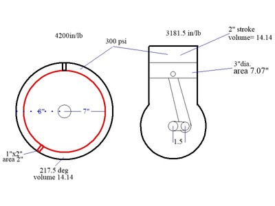

Previous in Forum: Two Air Cylinders in Series? Parallel?   Next in Forum: Ratchet Piston Engine Design
88 comments
Join Date: May 2012
Posts: 158
Rotary Piston Engine
05/06/2020 1:14 PM
I have been working on this design many years now.
Had problems with the seals but I believe when this is solved, it would be the most efficient engine ever built.
TommeyReed
Re: Rotary Piston Engine
05/06/2020 1:49 PM
Okay. Good for you.
I presume you don't have data to support this claim because the seal problem, though much improved, still lingers.
I applaud your enthusiasm and confidence. Go get 'em.
Join Date: May 2012
Posts: 158
Re: Rotary Piston Engine
05/06/2020 3:05 PM
Yes I do have some data, based on compress air efficiency that is 72% @120 psi using custom 5" ring seals and 1"x2" vane seal.
That is less then 2%-5% of combustion when using fuels.
I used a small engine to compress air/fuel mixture into the external combustion chamber.
TommeyReed
Re: Rotary Piston Engine
05/06/2020 4:03 PM
Your data looks more like unsubstantiated results rather than anything one should brag about. Having somebody verifying your measurement techniques (metrology) and calculations will go a long way. Better yet will be to have them to perform their own tests on the new engine design with their instruments.
Here's an approach you might try to make realistic data with this design. From the apparent size (judged by spark plug dimensions) the power of this engine is probably in the range of a small electric generator engine, ~2000W. Measure the amount of time a COTS 2000W generator can power 1000W of a resistor load (space heater) with a cup of gasoline. Then replace the ICE engine with your new engine and power the same load and only one cup of gasoline and compare running time.
Posts: 1394
Re: Rotary Piston Engine
05/06/2020 11:58 PM
It is difficult to visualize the seal problem from the patent drawings, esp without the parts key right at hand. As we see for 4 stroke internal combustion engines, a set of simplified diagrams showing the combustion stages and the component positions at each point would make it easier for someone to get an idea of the forces on the seals. We can find Wankel engine cycle diagrams, for instance, and see what the major components are.
Re: Rotary Piston Engine
05/06/2020 4:09 PM
The posted image is too small to read. I can't see anything in it that looks like a piston, nor anything that looks like rotary. Conceivably the write-up explains this, but it too is unreadable.
Do you have a link or other scheme that actually gives any useful information?
Re: Rotary Piston Engine
05/06/2020 5:56 PM
Re: Rotary Piston Engine
05/06/2020 6:28 PM
That didn't help even a tiny bit. The images were even harder to see than before, and the write-up was unspeakably terrible.
Evidently this thing has been around since 2004, with no apparent progress since then.
Re: Rotary Piston Engine
05/06/2020 8:10 PM
Re: Rotary Piston Engine
05/06/2020 9:33 PM
That doesn't explain even a single damned thing, Buferd.
For instance, what is item 50? A bolt with threads that don't engage anything whatsoever? JHFC, how can anyone be so wretchedly dumb as to buy into this nonsense?
Re: Rotary Piston Engine
05/06/2020 9:56 PM
So , can I put you down for 2..?
Re: Rotary Piston Engine
05/06/2020 11:15 PM
No, but thank you for clarifying about who would fall for it.
Re: Rotary Piston Engine
05/06/2020 11:45 PM
This would have made a great "What is it?" picture....
Re: Rotary Piston Engine
05/07/2020 12:24 AM
Maybe, or maybe not, but what in hell does this have to do with my post?
Re: Rotary Piston Engine
05/07/2020 1:29 AM
Whaddaya mean would have?
I have read all the posts here, and I still have absolutely no idea what that image depicts.
Re: Rotary Piston Engine
05/07/2020 3:18 AM
Is it another candidate for the museum of unworkable devices?
Join Date: Aug 2006
Location: Western Australia
Posts: 767
Good Answers: 58
Re: Rotary Piston Engine
05/07/2020 2:48 AM
Glad you also found this useless. Thought I was being dumb not understanding.
How did anyone grant a patent based on those drawings?
Re: Rotary Piston Engine
05/06/2020 8:24 PM
Well it appears to be a lawnmower engine that is supercharged by another lawnmower engine ...
Re: Rotary Piston Engine
05/07/2020 12:30 AM
Is this anything like the rotating rocket engine...?
World-first "impossible" rotating detonation engine fires up
https://newatlas.com/space/rotating-detonation-engine-ucf-hydrogen-oxygen/
Join Date: Aug 2006
Location: Western Australia
Posts: 767
Good Answers: 58
Re: Rotary Piston Engine
05/07/2020 2:57 AM
This will be great if they can scale it up and get it right.
Re: Rotary Piston Engine
05/07/2020 3:35 AM
Still needs a lot of testing, but yes looks very promising...I love it when guys do the impossible....
Re: Rotary Piston Engine
05/07/2020 3:37 AM
Join Date: Sep 2012
Posts: 230
Re: Rotary Piston Engine
05/07/2020 10:36 AM
"Shark Tank"?
Re: Rotary Piston Engine
05/07/2020 7:27 AM
"Had problems with the seals"
Have you thought about great white sharks?
Sorry, couldn't resist.
Re: Rotary Piston Engine
05/08/2020 11:12 PM
Ruuun Forrest,, RUN !!!
Location: Eastern Kansas USA
Posts: 1503
Good Answers: 128
Re: Rotary Piston Engine
05/07/2020 12:28 PM
Mr. Reed has put a lot of effort into it, based on the patent application. Unfortunately for him, it lapsed 7 years ago. I read through the papers and had no difficulty in reading it or seeing the drawings at any desired magnification. Perhaps Tornado needs to use a computer with a decent monitor instead of a smart phone.
The overall impression I get is that the engine has a large number of moving parts, which can cause mechanical losses and increased problems with seals, etc. Also, it appears to have a fairly large mass, but that may be a completely erroneous observation. In that regard, a Wankel type engine has very few moving parts and a very low mass compared to its output power--I say this from personal experience with an early RX2 car. It did suffer from lower efficiency than I would have expected or desired. Perhaps that is the reason why Mr. Reed has done his work.
--JMM
Re: Rotary Piston Engine
05/07/2020 1:46 PM
You are mistaken about the smart phone. My monitor is an Acer P215H with good enough resolution for AutoCAD™.
On a second reading of SE's post of the patent, I found some image manipulation features that were not immediately apparent. That solved the visibility issue.
I agree about the very large number of parts.
Join Date: May 2012
Posts: 158
Re: Rotary Piston Engine
05/07/2020 5:05 PM
The drawing and design was my own, detail to get a good understanding what it is.
I realize that having a external combustion chamber has it's benefits, almost like a combustion chamber in a jet engine. The big difference is compressed air enter into the chamber at 150psi that is sealed with a special valve, at combustion the timing release the expanding gases to drive any type of mechanical device. the patent is the combustion chamber, not the engine.
The engine was used just to compress air/fuel. The combustion chamber is to drive the rotary.
TommeyReed
Re: Rotary Piston Engine
05/08/2020 2:18 AM
On what grounds would this ever be the most efficient engine ever built? I don't see any energy cycle data in your deficient literature, not even Carnot efficiency.
Join Date: May 2012
Posts: 158
Re: Rotary Piston Engine
05/08/2020 7:12 AM
Efficiency is much more then moles and air flow.
I'm studying this field with, " The Internal combustion Engine in Theory and Practice". by Charles Fayette Taylor.
Heat is where all this energy is transfer into mechanical work. A piston type engine is not efficient, 22%-25% average, due to expanding pressures and mechanical conversions where most of the energy is release.
The rotary design allows a complete 250deg power stroke, unlike a 2/4 stroke engines where most of the power is at 90% of the crank shaft.
This is my design verse a standard piston engine drawing, even a cave man could figure that out.
This is just the torque on both engine at stall, the rotary did more work with 217.5deg vs 90deg of a 4 stroke engine.
My design would take less energy to produce more mechanical work.
(4 stroke) 90deg power stroke vs (rotary piston) 217.5deg power stroke.
TommeyReed
Re: Rotary Piston Engine
05/08/2020 7:49 AM
As Tornado and I point out, your claims are not substantiated. Denigrating your critics by comparing our free insight with cavemen does not help your position.
Join Date: May 2012
Posts: 158
Re: Rotary Piston Engine
05/08/2020 8:12 AM
To suggest I'm calling both of you cavemen, is just you over reacting.
My drawing was simple, even a cave man can understand.
Maybe it's best you move on, don't want to offend you being so sensitive.
Some of the past comments are a bully tactics, but clearly I'm not offended,
Common sense with mechanical work speaks for it's self, but some people can't grasp that.
Have a wonderful day.....
TommeyReed
Re: Rotary Piston Engine
05/08/2020 11:59 PM
You are coming off as combative and reactively defensive. Let's put that aside for now.
Your claim is that this engine would be more efficient because the power stroke takes up 217.5° (presumably out of 360°) and this is a larger portion than 90° out of 360° for a four stroke..
Assuming that I understand your argument, let's consider it in two ways: first, is that accurate; second, does having a power stroke that occurs over a greater portion of the cycle correlate strongly enough with efficiency to make your argument reasonable.
Beginning with the 90° out of 360° for a four stroke:. If we are talking about degrees on the crankshaft, this is not correct (though the ratio is correct). The power stroke on a four stroke is 180° on the crankshaft out of 720° for the cycle. So 25%.
As for a a rotary engine, the crankshaft speed and the rotor speed are typically some ratio other than one to one, (Wankel engine for example turns the rotor at 3 times the crankshaft speed) so it is arbitrary. What could be considered to make the comparison equivalent would be the portion of the complete cycle (at constant rotor speed) that is the power stroke. If your engine has roughly equal time spent for each separate process of intake, compression, power and exhaust, then it will be roughly 25%. If your engine has compression and combustion decoupled from the power stroke, then, perhaps the power stroke runs 50° of the time and the exhaust stroke (bringing the mechanism back to the starting point in the cycle ready to have work done on it by expanding hot gasses of combustion) runs 50% of the time.
Perhaps with decoupled compression and combustion along with some clever dual action on the driven component, the power can be realized over 100% of the stroke.
So perhaps your engine does experience a power stroke that is a greater portion of the entire cycle. I do not know because I don't know the relative times for other competing processes.
Assuming it does, does that suggest it will be more fuel efficient?
We can look at existing mature technology for insight.
A two stroke engine has a power stroke that is 50% of its cycle compared to the four stroke just having 25% of its cycle as power.
A power turbine realizes power ~100% of its cycle.
If your reasoning is appropriate and sound, for the same power output, a turbine and the two stroke should both yield better fuel efficiency than a four stroke.
That is not the case however. For the same power output, the four stroke can be made more efficient than either the turbine or the two stroke.
Not only is your supposition not correct, the correlation is in fact the opposite, suggesting a power stroke that is a smaller fraction of the total cycle is correlated with higher fuel efficiency.
Location: Eastern Kansas USA
Posts: 1503
Good Answers: 128
Re: Rotary Piston Engine
05/10/2020 1:21 PM
Truth..,
A minor correction. The 3:1 ratio on a Wankel engine has the output shaft rotating three times for each rotation of the rotor, not the opposite.
--JMM
Re: Rotary Piston Engine
05/11/2020 3:51 AM
Good catch. Thank you for the correction.
Re: Rotary Piston Engine
05/11/2020 7:30 AM
The concept of <...Maybe it's best...cavemen...move on...> is at odds with the concept of peer review, which seems to be the reason for the existence of this thread.
So far, peer review has achieved little other than <...offend...>. Maybe the style of the message is in need of improvement, perhaps?
Re: Rotary Piston Engine
05/08/2020 12:16 PM
First, I definitely do like the concept of eliminating reciprocating motion from engines, so the initial thought of your rotating vane (I refuse to call it a piston) is good. Also I definitely commend you for actually constructing a prototype.
But! You now have the reciprocating "door" that must move out of the way each time the vane passes and then quickly close again. That's definitely a problem.
I have read a fair portion of the patent document and studied a few of the drawings, so I think I understand how the device is intended to work, but there are too many details not addressed, and some definite inconsistencies. At one point you mention a microprocessor-controlled timing of the ignition spark, but then you proceed to describe what sounds to me like a standard magneto system.
Probably the greatest flaw is not considering the energy required to compress air and fuel. Both of these processes are external to your "engine". Likewise, the external combustion chamber is a real energy sink. No matter how carefully you craft the passageway for the combustion products from the combustion chamber into the working chamber, there will be considerable reduction in pressure as the mixture follows this path.
Gasoline burns much too rapidly to work well in this engine; you need a fuel that will continue to burn for a large fraction of that 250° rotation. Gasoline would provide a burst of pressure at ignition, but the small pathway for that expanded mixture to enter the working volume will greatly reduce that pressure.
Finally, your "caveman" drawings are very misleading, because the two drawings are not to the same scale. Your 3" diameter piston is shown very nearly the same size as the 8" outside radius of your rotary vane.
Thanks for trying, but I don't see this as workable.
Join Date: May 2012
Posts: 158
Re: Rotary Piston Engine
05/08/2020 1:06 PM
The two types of engines are different, but the same amount of displacement are identical.
Instead of doing the math and insult anyone, I did it and that's the same travel volume.
I do agree with the piston gate, that's also why I built my design like this.
This design works much better, this is how the updated build was.
This is a single vane motor, but you could stack them to gather with a off set of 90deg to make a 4 vane motor
TommeyReed
Re: Rotary Piston Engine
05/08/2020 5:29 PM
I presume the downward-pointing arrow represents the combustion mixture passing from the external combustion chamber into the working volume. That opening is nearly sealed off from the working volume by the rotating cylinder, so the mixture can't really get in to the working volume! It's difficult to tell what's what in this drawing; but I presume the black rectangle at the bottom is the vane, and the black rectangle at the top is a seal. What happens when the vane hits the seal?
I think I've wasted enough of my time going down this rabbit hole! I'll keep watching, in case you come up with a real practical innovation.
Re: Rotary Piston Engine
05/08/2020 4:10 PM
Yo, Thag--why wheel no turn?
Re: Rotary Piston Engine
05/08/2020 5:02 PM
Your drawing is massively deceiving!
Here is the drawing with the rotary engine shown at the same scale as the piston engine (using the dimensions given on the drawing of the rotary engine):
I don't know how you calculated the working volume of your rotary engine, but the calculation is way off, unless I totally misunderstand the engine drawings!
Join Date: May 2012
Posts: 158
Re: Rotary Piston Engine
05/08/2020 6:27 PM
did I make a mistake?
the vane surface is 1x1x2= 2cu/in
a. = (8"dia. area ) pi(r^2)=50.265482246cu/in
b. = (7"dia. area =pi(r^2) =38.49451001cu/in
c. = a/b=11.77097224cu/in at 360 deg rotation
d. =c/360=0.03269714511cu/in per degree
e. =d*2" = 0.06539429022 (2" width)
14.14/e =216.23 deg.
I believe your area calculation is off. (pi*r^2)= 402cu/in?
pi * (4^2) =50.265448246 cu/in
TommeyReed
Re: Rotary Piston Engine
05/08/2020 6:39 PM
Here are your new mistakes in this post:
1. The vane area is just 1 x 2 = 2 in2, not in3.
2. There is on such unit as cu/in, anyway.
3. In your original drawing, the 8" and 7" are radii, not diameters.
4. From there on, everything is wrong.
Re: Rotary Piston Engine
05/09/2020 1:21 AM
Not a mistake; several!
As Tornado pointed out, your original drawing indicates that the 7" and 8" values are radii. Those values are consistent with a vane height of 1". If those values are diameters, then the vane height must be 0.5", and the surface area of the vane is then 1.0 sq.in.
I don't know what kind of calculator you used, but I did your calculation a. on, but working backwards (dividing your value of 50.265482246 by 16 gives a value of pi=3.141592640, while a more precise value of pi is 3.1415926554, rounded to the 9 digits past the decimal point that you show. Yes, this is nit-picking, but since you showed your answer with eleven digits of precision, it ought to be correct to that many digits. My calculators (two totally separate ones) both give an area for the 8" diameter circle of 50.265482457, which only agrees with your value to six digits past the decimal point.
You give a value of 38.49451001 for the 7.5" circle while my calculators give 38.48451001, so I have to assume that you mistyped the 9 instead of an 8.
Calculated values can NEVER have greater precision than the lowest precision value used in the calculation, so piX4.00"x4.00" gives a value of 50.3 sq.in. (3 significant digits). If you specify the 4" radius to the nearest thousandth (4.000"), then you can specify the area as 50.27 sq.in. (4 significant digits). You MUST discard all those extra digits in the calculated answer.
cu/in might be read as cubes per inch or ???. In the inch system, areas are always measured in square inches, which can be abbreviated as sq.in., or in^2, or in2, and possibly other correct abbreviations, but NOT cu/in NOR sq/in.
In your calculation c, a/b is a standard notation for a divided by b. I presume you meant a-b (b subtracted from a). 50.27...-38.48...gives a value of 11.78... I won't quibble over that fourth digit. This is the ring surface area in square inches. If rounded to three digits of precision, I agree with your d. value of 0.0327, in units of square inches per degree.
Multiplying that value by the 2" vane width does give 0.0654 cubic inches of volume per degree of rotation.
Only now, after going through all that, does it suddenly become apparent where you got the 216...degree angle. You are determining how far (how many degrees) your vane must rotate in order to have the same displacement as the illustrated piston engine's 14.14 cubic inches. ...and yes, that is correct: Your vane must rotate 216° in order to have experienced the same displacement as one stroke of the piston.
But what is the significance of that value of 216°. In perusing the patent document, I failed to notice how you exhaust the spent gasses. In your post #28, you mention a power stroke of 250°. That means you must exhaust those spent gasses in something under 110° of further rotation. Since the gasses have transferred energy to the vane during the power stoke, they are cooler and at lower pressure during the exhaust portion of the stroke, so the exhaust port must be significantly larger than the entry port.
Now you say that the piston engine has a 2" stroke, yet show a 1.5" offset on the crankshaft. As pointed out by Tornado, the piston stroke MUST be exactly twice the crankshaft offset, so either your stroke and displacement values are wrong, or the crankshaft offset and the torque values are wrong.
The torque value of 4200 in-lb for the rotary engine is a bit low; you used the 7" radius, while the correct theoretical value would use 7.5" (the center of the vane), giving 4500 in-lb. BUT! Those values are for a 16" outside diameter vane. If you change the 7" and 8" to diameters, then the torque radius drops to 3.75" and the vane area drops to 1.0 sq in. (0.5"2"). In that case, the torque becomes 300PSI x 1.0 sq in x 3.75 in = 1125 in-lb, and of course that is the zero-friction theoretical torque. The real achievable torques will be considerably less, for both kinds of engines.
Join Date: May 2012
Posts: 158
Re: Rotary Piston Engine
05/09/2020 7:04 AM
I see some of my questions, going back and forth I did make a few mistakes.
The 2in stroke was off and should have been 1.5in and 3" would be the complete stroke as Tornado mention.
I was going to calculate 7.5" instead of 7" for torque, but wanted to see if anyone understand that, yes I was going to bring this up!
Someone numbers was way off, I know we all make mistakes.
I wasn't the only one who made mistakes, but at the end of the day my calculation was correct!
The exhaust port is in Fig. 4A 16, It is far greater then the intake.
My calculator is a Casio Fx-115 ES and did on purpose added all the extra 9 decimal numbers because some people needed it.
"When people get into details, they make mistakes and never end up building nothing"
TommeyReed
Re: Rotary Piston Engine
05/09/2020 1:32 PM
"...added all the extra 9 decimal numbers because some people needed it."
NO! It is indeed a good idea to include one or two extra digits in intermediate calculations, rounding off the final answer to the appropriate number of digits. No one needs anything beyond that.
Absolutely true that we all make mistakes, but please use correct English! ("...never end up building nothing") [double negative]
Unless your "Engine" can power its own compressor and pumps, it isn't an engine, but an add-on to another engine.
Once again, I commend you for trying, but I'll be flabbergasted if this goes anywhere.
Re: Rotary Piston Engine
05/08/2020 6:31 PM
In addition to dkwarner's notes, here are some of your other mistakes:
Areas are expressed as in2, not inches (e.g. ~7.07 in2 for area of 3-in circle).
If the piston stroke is only 2 in, the crank won't even go around.
The crank arm is visibly shorter than the piston radius, even though both are supposedly 1.5 in. Inaccurate drawing or labeling.
Torques are not expressed as lb/in (which reads as pounds per inch); the correct units are lb-in (which reads as pound-inches). Your torque numbers are good, though, just not the units.
Join Date: May 2012
Posts: 158
Re: Rotary Piston Engine
05/08/2020 6:35 PM
Your right, I should have wrote it down right.....
I wasn't making a perfect drawing,either.
My mistake, it won't happen again!
TommeyReed
Re: Rotary Piston Engine
05/11/2020 3:07 AM
The whole point of posting though is for the <...caveman...> to review. If the <...caveman...> verifies the outcome, then the design is solid. That's the principle behind peer review.
This thread didn't get that far.
Re: Rotary Piston Engine
05/11/2020 3:24 AM
The problem with peer review is that for any doofus who dreams up a goofy idea, his/her peers will also be doofuses. Instead, the proper standard is competent critical review, which is quite rare.
Re: Rotary Piston Engine
05/11/2020 3:26 AM
Indeed.
The <...cavemen...> correlation is astonishingly rude.
Join Date: May 2012
Posts: 158
Re: Rotary Piston Engine
05/11/2020 6:44 AM
I see it this way!
Two people who are either too old to build anything and won't post a single thing they made because they themselves would be a laughing stock on these forums.
I fully understand the bully tactics, I would also add that people like you are making comments though out these forums because you can't even put up a single thing.
Why do you keep posting on my forum? Not only is your math skills is off, it was flat out wrong and got a D in my book.
Did you pay to get these skills? Making a simple mistake is one thing but you clowns act as experts.
I like to see what you clowns built, if you are going to bully people then you must be experts to show something you build by hand.
Everything I built was from myself, I love to see both of your work.
Be very careful when you bully someone, some people react different then others!
Lets see what you built experts.
TommeyReed
Re: Rotary Piston Engine
05/11/2020 7:16 AM
If others want to build something and post it for peer review, then the correct vehicle for this is a different thread.
This thread, however, is about the <...Rotary Piston Engine...>. Please keep this thread "on topic".
Re: Rotary Piston Engine
05/11/2020 10:49 AM
Since your post #50 was not in reply to any specific other post, I have to assume that you are talking to/about all of those here.
Yes, many of us here are are old enough to be partially or completely retired, but don't forget that "old" also means "experienced". Most of us here are here because we want to help others solve problems. Each of us has had a different set of experiences; together, we can help solve many different kinds of problems. As you can see if you look, I've been doing this for fourteen years.
You want to see something we've made. Here is a machine I made, entirely by myself, in my own garage, with my own tools, almost exactly 20 years ago. The photo was taken with the first digital camera I had available, so isn't of high resolution:
I won't give any details, but it it did the required job!
I think I've read all of the posts in this thread, and I don't remember any that could be described as "bully tactics".
Whose math skill are off? Some of my calculations didn't agree with yours, because they were based on the incorrect dimensions of your drawings.
I probably should not have responded to your post at all, and I won't respond to the rest of your rant.
Join Date: May 2012
Posts: 158
Re: Rotary Piston Engine
05/11/2020 1:04 PM
A bunch of roller, did you come up with that yourself?
sorry to see you go, see you....lol
TommeyReed
Re: Rotary Piston Engine
05/12/2020 7:21 AM
A contributor with >5500 posts and >215 good answers is an unlikely candidate for the departure lounge.
In reply to #66
Re: Rotary Piston Engine
05/12/2020 11:25 AM
Thank you, and you're right. I did say something to the effect that I have wasted enough time on this thread, but that I'd keep watching. I continue that policy, although it's been quite a while since I saw anything useful here.
Re: Rotary Piston Engine
05/11/2020 2:24 PM
That is ungrammatical, untrue, and impolite.
Join Date: May 2012
Posts: 158
Re: Rotary Piston Engine
05/11/2020 4:11 PM
This post was deleted because it was an attack on another user. Please review the Site FAQ and the Rules of Conduct.
TommeyReed
Re: Rotary Piston Engine
05/11/2020 4:55 PM
My most "fantastic" build consisted of 17 piping systems totaling about 35,000 feet in a fish processing plant on Akutan Island, in the Aleutians. Much of it was bent piping rather than elbows. I devised a 3-D vector system using determinants and the laws of sines and cosines to calculate bend angles and rolls between successive bends. (Too bad I never commercialized that.)
Over the years I have fabricated a number of mechanisms. Most are prior art, hence not inventions, but the craftsmanship is pretty good.
Your comments on dkwarner's device are insulting. So who's the bully?
Re: Rotary Piston Engine
05/11/2020 7:11 PM
There is obviously a breakdown in communication here. The information might not be received in a way that makes its value clear up front.
Dunning & Kruger did an informative study that would be a useful reference to keep handy (for anyone unfamiliar with the style of explanation typical of an inventor of your experience and mindset) when reviewing your introduction to your work. Familiarity with Dunning Kruger is an excellent tool that can unlock the true worth of many ideas of individuals who refuse to be trapped by the values touted in an imagination crushing 'standard education'. The type that gives reverence to widely accepted standards.
It does seem your passion has allowed you to get sidetracked with comments that don't seem to be what you came here for. You have overlooked a couple comments and left those unanswered.
Specifically I left comment #41. I'm calling for you to back up your claim about a longer power stroke being correlated with higher efficiency. Alternately, perhaps you could posit other ideas about why you feel this could be the most efficient engine ever created.
Join Date: May 2012
Posts: 158
Re: Rotary Piston Engine
05/11/2020 8:29 PM
That sound like a good question.
I will clarify instead of getting off track.
TommeyReed
Join Date: Aug 2006
Location: Western Australia
Posts: 767
Good Answers: 58
Re: Rotary Piston Engine
05/12/2020 12:51 AM
I don't understand much of what the OP has said, but certainly in the marine diesel engine field a longer stroke does improve efficiency. Cant see it being any different in other engines.
"Simple geometric relationships show that an engine cylinder with longer stroke-to-bore ratio will have a smaller surface area exposed to the combustion chamber gasses compared to a cylinder with shorter stroke-to-bore ratio. The smaller area leads directly to reduced in-cylinder heat transfer, increased energy transfer to the crankshaft and, therefore, higher efficiency."
Re: Rotary Piston Engine
05/12/2020 2:03 AM
Do you have a source for that quotation?
IIRC, for a cylinder the largest volume-to-surface-area ratio occurs when the diameter and height (or stroke) are equal; i.e. "square".
Join Date: Aug 2006
Location: Western Australia
Posts: 767
Good Answers: 58
Re: Rotary Piston Engine
05/12/2020 5:48 AM
Don't know what IIRC stands for, but there are many "sources" on google. You can get more power out of a square or even over square engine, but not more thermal efficiency. However, there are many other considerations, amongst them the increased size of the engine with the longer stroke and the higher rpm of the lower.
From Wiki
Oversquare engine examples[edit]
Oversquare engines (a.k.a. "short stroke engines") are very common, as they allow higher rpm (and thus more power), without excessive piston speed.
Examples include both Chevrolet and Ford small-block V8s. The BMW N45 gasoline engine has a bore/stroke ratio of 1.167.
Horizontally opposed, also known as "Boxer" or "flat", engines typically feature oversquare designs since any increase in stroke length would result in twice the increase in overall engine width. This is particularly so in Subaru’s front-engine layout, where the steering angle of the front wheels is constrained by the width of the engine. Although oversquare engines have a reputation for being high-strung,[citation needed] low-torque machines, the Subaru EJ181 engine develops peak torque at speeds as low as 3200 rpm.
Nissan's RB, VQ, VK, VH and VR38DETT engines are all oversquare. Additionally, SR16VE engine found in Nissan Pulsar VZ-R and VZ-R N1 is an oversquare engine with 86 millimetres (3.39 in) bore and 68.7 millimetres (2.70 in) stroke, giving it 175–200 horsepower (130–150 kW) but relatively small torque of 119–134 pound-feet (161–182 N⋅m; 16.5–18.5 kg⋅m)
Extreme oversquare engines are found in Formula One racing cars, where strict rules limit displacement, thereby necessitating that power be achieved through high engine speeds. Stroke ratios approaching 2.5:1 are allowed,[a] enabling engine speeds of 18,000 rpm while remaining reliable for multiple races.[4]
The Ducati Panigale motorcycle engine is massively oversquare with a bore/stroke ratio of 1.84:1. It was given the name "SuperQuadro" by Ducati, roughly translated as "super-square" from Italian.[5]
The side-valve Belgian D-Motor LF26 aero-engine has a bore/stroke ratio of 1.4:1.[6]
Early Mercedes-Benz M116 engines had a 92 millimetres (3.62 in) bore and a 65.6 millimetres (2.58 in) stroke for a 3.5 litre V8.[7]
Undersquare or long-stroke engine[edit]
An engine is described as undersquare or long-stroke if its cylinders have a smaller bore (width, diameter) than its stroke (length of piston travel) - giving a ratio value of less than 1:1.
At a given engine speed, a longer stroke increases engine friction and increases stress on the crankshaft due to the higher peak piston acceleration. The smaller bore also reduces the area available for valves in the cylinder head, requiring them to be smaller or fewer in number.
Undersquare engines exhibit peak torque at lower rpm than an oversquare engine due to their longer crank throw and high piston speed.
Undersquare engines have become more common lately, as manufacturers push for more and more efficient engines and higher fuel economy.[8] Undersquare engines have a higher volume/surface area ratio,[further explanation needed] leading to reduced heat loss and higher BSFC.[9]
In reply to #64
Re: Rotary Piston Engine
05/12/2020 5:49 AM
Location: Stoke-on-Trent, UK
Posts: 4499
Good Answers: 137
In reply to #64
Re: Rotary Piston Engine
05/13/2020 7:39 AM
The Wiki article says "Undersquare engines exhibit peak torque at lower rpm than an oversquare engine due to their longer crank throw and high piston speed".
Maybe peak torque at lower rpm is correct (I wouldn't know) but the idea that higher torque is given by longer crank throw is a common misconception. For a given cylinder volume and gas pressure, torque is independent of bore/stroke ratio.
"Undersquare engines have become more common lately, as manufacturers push for more and more efficient engines and higher fuel economy.[8] Undersquare engines have a higher volume/surface area ratio,[further explanation needed] leading to reduced heat loss and higher BSFC.[9]"
Volume/surface area ratio is maximum when square, as can be shown by basic calculus. It's not clear why reduced heat loss would be an advantage. Rejected heat has to be disposed of, and what doesn't go out with the exhaust gas goes through the cylinder walls or overheating of the piston and cylinder would result. Also BSFC refers to fuel consumption so is lower when efficiency is higher.
Join Date: Aug 2006
Location: Western Australia
Posts: 767
Good Answers: 58
In reply to #70
Re: Rotary Piston Engine
05/13/2020 7:54 AM
My comment concerns efficiency, nothing to do with torque. Reduced heat loss means that it is "not a loss" - hence more efficient.
Location: Stoke-on-Trent, UK
Posts: 4499
Good Answers: 137
In reply to #71
Re: Rotary Piston Engine
05/13/2020 8:41 AM
I was just commenting on the Wiki article.
As I'm sure you know, heat loss cannot be reduced at will. The engine is (presumably) designed to be as efficient as possible with the techniques and materials available. That then determines the quantity of heat rejected, which the cooling system has to deal with.
Re: Rotary Piston Engine
05/15/2020 11:55 AM
Tornado, what you say is true, but remember that the highest temperatures (and therefore greatest delta T and heat transfer) occurs near TDC.
While a 'square' set up has the least surface area per average volume of the cylinder, to get the least surface area per volume when it is most important (near TDC) an 'under square' set up is required.
Join Date: May 2012
Posts: 158
In reply to #74
Re: Rotary Piston Engine
05/15/2020 1:05 PM
That is very true, at TDC the heat produce is the maximum pressure that can't produce any mechanical work in a IC engine.
As the piston moves downward, pressure decrease while converting this into work. Only at 90 degree of a crank shaft is where the maximum power output is being produce, while pressure decrease exponential.
I'm working on the formula, but I must find a basic molecule of heat in gasoline.
If Gasoline has a average of 125,000 BTU's or 3785.412cc
The required formula for the calculation of the moles of gas is given below.
PV=nRT
Where,
  • P is the pressure.
  • V is the volume.
  • n is the number of moles.
  • R is the gas constant.
  • T is the temperature
The value of gas constant is R=0.0821
What is the true answer of heat energy produce from 1cc of gasoline.
33 BTU for 1 cc?
Does 1 BTU heat air volume the same as 1 pound of water 1 degree?
I believe I need all this input to show if the rotary engine is more efficient with same amount of fuel.
If average TDC psi is around 1,500-1,800 psi, how much fuel was used?
TommeyReed
Location: Stoke-on-Trent, UK
Posts: 4499
Good Answers: 137
In reply to #75
Re: Rotary Piston Engine
05/16/2020 9:48 AM
"What is the true answer of heat energy produce from 1cc of gasoline. 33 BTU for 1 cc?"
That's about right. Gasoline and similar hydrocarbons have calorific value 44MJ/kg, and gasoline SG ~ 0.8.
"Does 1 BTU heat air volume the same as 1 pound of water 1 degree?"
No. Specific heat of air at constant pressure is ~ 1000kJ/kg/K ~ 240BTU/lb/°F. And for air volume you need the density, which varies with pressure and temperature.
I don't think calculation will give your engine efficiency with any confidence. The only way IMO is to build and test it. Good luck!
Join Date: May 2012
Posts: 158
In reply to #76
Re: Rotary Piston Engine
05/16/2020 10:04 AM
Thank you....
I agree that a prototype is where you would get a more accurate result.
How about if I base it on just combustion chamber psi with the same amount of volume; like a small single piston engine vs a rotary, would that give enough input data to compare the efficiency?
I realize formulas can only answer the possibility, but it would give some indication of efficiency would it not?
TommeyReed
In reply to #77
Re: Rotary Piston Engine
05/16/2020 11:34 AM
I was under the impression the the device pictured in post #2 IS your prototype.
If it is, then have you had it running? Since you mentioned using a separate engine to power the compressor, I assumed that you have...
If you have had it running, have you had it connected to a dynamometer (or other appropriate device) to measure the power output? And of course you must independently connect that compressor engine, under similar conditions, to a dynamometer (or other appropriate device) to measure its output, then subtract that power from the combination power output to determine the power added by your device.
Join Date: May 2012
Posts: 158
In reply to #78
Re: Rotary Piston Engine
05/16/2020 12:08 PM
I didn't have enough compression due to the combustion chamber size, it needed more compression strokes to get it to a combustion point.
So, I'm working on a simpler design.
That's also why the rotary design had 4 piston to pump the volume and compression needed for the combustion chamber.
TommeyReed
In reply to #79
Re: Rotary Piston Engine
05/16/2020 1:45 PM
Then you have wasted everyone's time on an already abandoned design version.
#82
In reply to #79
Re: Rotary Piston Engine
05/16/2020 1:58 PM
...and for that:
<unsubscribes>
#83
In reply to #79
Re: Rotary Piston Engine
05/16/2020 4:12 PM
If you ever come up with something that works, please start a new thread. Till then, good luck!
Re: Rotary Piston Engine
05/15/2020 11:45 AM
The OP wasn't talking about under square or over square engines and being over square or under square has no effect on the portion of the full cycle that the power stroke comprises.
I do agree with you that having a longer stroke relative to bore can improve efficiency because when at TDC, the surface area to volume ratio will be less than something with the same displacement engine with a shorter stroke relative to bore. That however wasn't the claim.
Less surface are to volume at combustion also does not appear to be a characteristic of the engine design discussed here. It would appear to have a rather thin flat combustion area that traverses additional surface as it compresses and expands as the seals both cover and uncover new bounding surface.
Re: Rotary Piston Engine
05/11/2020 11:49 PM
What's this nonsense about "liberals"? Nothing in this thread so far has been about politics, so that is just irrelevant (and inaccurate) name-calling on your part.
Re: Rotary Piston Engine
05/12/2020 3:11 AM
<...math skills is off, it was flat out wrong...>
Having scanned this thread several times it is proving difficult to see where any calculation is displayed that might attract comment, let alone critique.
The local optician's shop is closed at the moment owing to a virus outbreak. First impressions are that going there for an eye test won't make much of a difference.
Re: Rotary Piston Engine
05/12/2020 10:37 AM
In that case, assuming the ambient temperature is the same across the new engine and an existing one, its operating temperature must be much higher, and in the case of the claim of its being the <...most efficient engine ever built...> would be the highest in one yet.
Some testing data would be of value to support the claim.
In reply to #67
Re: Rotary Piston Engine
05/12/2020 2:45 PM
Yes, actual testing data along with the metrology method will go a long way to support any claim. (Didn't somebody mention this earlier? )
Whenever any design strays significantly from standard design practices, one shouldn't rely too much on the engineering mantras of the standard design. This engine design clearly strays significantly from the standard two or four stroke piston engine. Therefore one shouldn't expect the mantra of bore/stroke ratio of a piston engine as proof of anything, let alone efficiency for this engine design.
#81
Re: Rotary Piston Engine
05/16/2020 1:56 PM
It ain't rocket science: shaft power out, divided by combustion power in.
Simples.
Join Date: Jun 2020
Posts: 4
#84
Re: Rotary Piston Engine
06/15/2020 5:56 AM
I have been working my way through this thread with increasing incredulity before reaching the point where I thought I might comment. Just to give a brief background to establish my qualification to do so: I have spent my entire career in the field of engine design and development. I have been incredibly lucky and have worked with engines for a huge variety of applications: from chainsaws, through motor cycles, cars, trucks to loco and marine. Petrol, diesel, gas, 2 stroke, 4 stroke and Stirling. I have fulfilled roles from detail designer, design analyst, performance development engineer through to Chief Engineer and Engineering Director - and always an engine man.
I think one fundamental point that should be made is that, whatever the detail configuration, these are Heat Engines and there are Physical Laws that brook no dissent! It has taken the discussion many iterations to get to defining what efficiency we must deal with here - overall thermal efficiency as PWS mentions in his last post.
The fundamental issue is the ratio between the chemical energy provided in the fuel and the brake power delivered at the output shaft after including any work done in inducing and compressing the charge.
There has been little mention of compression ratio - but this is critical as it places a hard thermodynamic limit on the theoretically achievable thermal efficiency even if all else was perfect. .This is known as the air standard efficiency and, for an Otto cycle engine it is notable for being a function of compression ratio and the properties of air - full stop. for a compression ratio of 11:1 the air standard efficiency is 61.7% and reality moves a long way downhill from there... For those who are into the detail of this sort of thing the ASE represents the first step down from the Carnot efficiency. Carnot showed that all heat engines, regardless of type have a maximum efficiency based on the highest temperature in the cycle and the ambient temperature - for a petrol engine this comes out in the low to mid-80% area.
Typically, promoters of a new engine concept have to start from this point and then show how their ideas will more closely approach the ideal than conventional layouts. The losses essentially boil down to pumping and combustion losses, losses to exhaust and friction (which includes, in my book, for convenience) all radiated heat losses because virtually all radiating surfaces are oil wetted internally and heat generated by friction losses are transmitted to the oil. If anyone wants to look up more detailed heat balances or Sankey diagrams - it's all there. Absolute state of the art best brake thermal efficiency for a passenger car sized petrol engine, at the best speed load point and still in R&D labs is in the region of 43-45%. The very best (and enormous) slow speed diesel marine engines achieve a best as high as 60% - but I think this figure includes significant exhaust gas heat recovery.
I must disagree with those who say that analytical techniques cannot help for new concepts and testing is essential - These days, using numerical methods and high end PC's astonishingly good simulations can be achieved (though beware garbage in, garbage out!) Because these approaches start from first principles new concept can be modelled accurately enough to show whether there is promise or not.
In this particular case, the benefits seem to be justified by assertion and based on a somewhat incomplete understanding of the system as a whole - and little else. The inventors last sketch shows that the power conversion mechanism is now a simple vane arrangement - which is not a new idea at all and incorporates, even exaggerates in some respects, all the sealing and surface to volume issues of the Wankel.
Relocation of the combustion chamber may address, to some extent the surface to volume ratio issues but this is not a new idea either - the pre-chamber is well established and it's many and considerable heat loss issues are well understood. I confess I do not understand the separation of compressed air and fuel as claimed (I deliberately do not use the word "described" because I find the language of the patent incoherent and impenetrable) but, until some over-riding benefit is explained to me - all I see is further thermodynamic and pumping losses in bringing air and fuel together for combustion.
This concept needs a lot of work before its credibility can be assessed and, in my experience, it will fall at an early stage of serious analysis before heavyweight methods are required.
For those interested in the field of unconventional engine concepts I recommend heartily Douglas Self's website:
http://www.douglas-self.com/MUSEUM/POWER/unusualICeng/unusualICeng.htm
Join Date: Aug 2006
Location: Western Australia
Posts: 767
Good Answers: 58
#85
In reply to #84
Re: Rotary Piston Engine
06/15/2020 6:05 AM
First comment - what a technically good one.
Welcome, hope you have the patience to stay.
#86
In reply to #84
Re: Rotary Piston Engine
06/15/2020 2:30 PM
I agree with The Prof! Welcome to CR4!
Join Date: Jun 2020
Posts: 4
#87
In reply to #86
Re: Rotary Piston Engine
06/16/2020 4:27 AM
What a very kind welcome, thank you both!
Location: Van Nuys, CA
Posts: 563
#88
In reply to #84
Re: Rotary Piston Engine
06/18/2020 9:58 PM
> For those interested in the field of unconventional engine concepts I recommend heartily Douglas Self's website:
http://www.douglas-self.com/MUSEUM/POWER/unusualICeng/unusualICeng.htm
What a fantastic resource! Thanks for sharing it!.
Register to Reply 88 comments
Anonymous Poster (2); Camshaft (2); Codemaster (3); dkwarner (11); Dr. Harry (1); jmueller (2); pantaz (1); PWSlack (10); Randall (1); redfred (4); rwilliams (1); SolarEagle (8); The Prof (6); TommeyReed (15); Tornado (16); truth is not a compromise (5)
Previous in Forum: Two Air Cylinders in Series? Parallel?   Next in Forum: Ratchet Piston Engine Design
