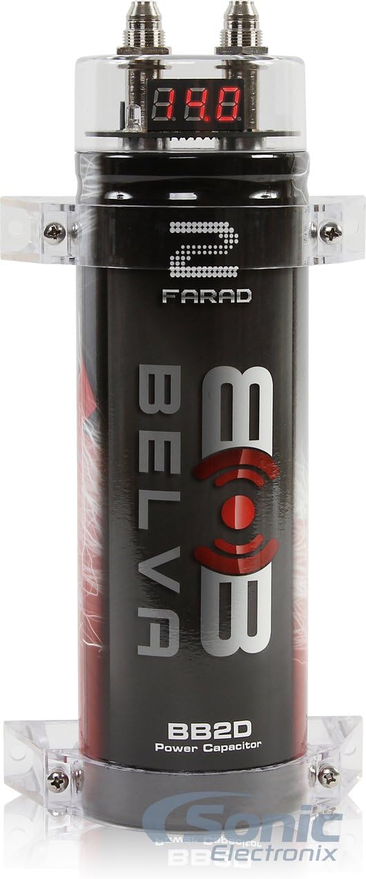

OK Lets go REAL BIG.These are 2 FARAD EACH !10-16 volts each.
How about 10 of these in series/parallel?
He needs 150Volts? No problem.
Total weight of 10 of these 29.4 lb.
Around $35 each.
