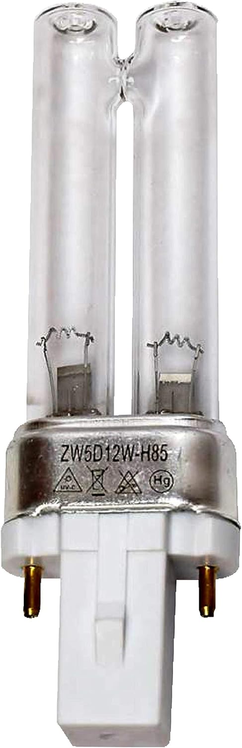

I guess you didn't see my links in #3 ...to this bulb
Voltage: 11V DC; Current: 0.3A; Base: E17; Intensity: 450uW/cm2 @ 30mm; Wavelength: 254nm
Why don't you think this is sufficient for an air chamber similar to that above...?
Re: Ultraviolet Virus Killer Masks
06/18/2020 3:19 PM
That bulb will likely help to sterilize the air in a room and certainly many of the exposed surfaces of said room but it will not have enough time to sterilize the air entering the lungs through a mask.
Now having one or a couple of these bulbs to sanitize the filtering surfaces of a reusable mask between uses sounds like a good idea.
06/18/2020 4:36 PM
..."So if your UVC lamp has an irradiance of 5 mW/cm2 at a specified distance from an object, then holding the lamp at that distance from the object for 8 seconds will deliver a dose of 40 mJ/cm2, because 5 mW/cm2 multiplied by 8 seconds = 40 mWs/cm2 or 40 mJ/cm2.
A dose of 40 mJ/ cm2 is generally considered sufficient to disinfect (99.9% reduction in infectivity) a wide range of bacteria and viruses, including certain coronaviruses that infect animals (Malayeri, IUVA News 2016)."....
https://www.consumerlab.com/answers/does-uv-light-kill-coronavirus/uv-light-covid/
https://www.researchsquare.com/article/rs-25728/v1
...."I understand one needs 1/100 of a watt-second per square cm for water purification using 254 nm UV. What is the dosage for air?
Most regulatory bodies now specify a fluence or UV dose of 40 mJ/cm2 (note that 1 mWs = 1 mJ) to assure at least 4 logs inactivation of any pathogenic microorganisms. Since the fluence or UV dose applied is independent of the medium, this requirement would also apply to air. However, I am not aware of any regulations as yet regarding UV air treatment."...
https://iuva.org/uv-faqs
=89 seconds of exposure for 99.99% kill....
..."The average minute ventilation is 6 litres per minute."...
= 9 liter tank...or two bulbs and a 4.5 liter tank...

A demonstration of "back of the envelope" engineering mathematics seems to be in order.
From the Wikipedia page on UVGI on inactivation of microorganisms:
Dosages for a 90% kill of most bacteria and viruses range from 2,000 to 8,000 μW·s/cm2
So the volume within 30 mm of one bulb will not be sterilized to 90% until at least 5 seconds of time has elapsed. A 30 mm diameter sphere is only 0.014 liters in volume. (V=4/3 * pi *r^2) The tidal breathing of the lungs were earlier identified as about 1.2~2 liters a second. One of these itty bitty bulbs will not sterilize 1 liter of air in a minute, let alone every second.
Ineffective personal protective equipment can easily become more dangerous than no personal protective equipment.
