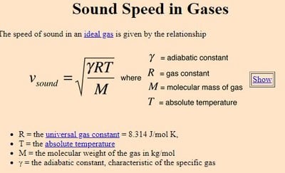

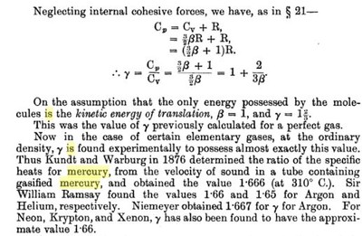

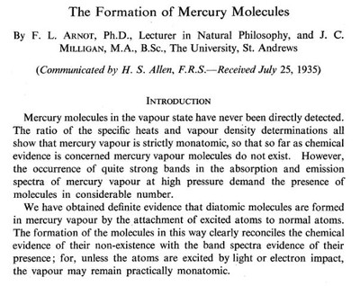

Previous in Forum: Adhesives to Fix Pinion to Nut?   Next in Forum: Wax Residue That Will Not Smudge When Touched
31 comments
Join Date: Jul 2009
Posts: 26
From Diatomic Oxygen to Peroxide
07/05/2020 10:56 AM
how to get peroxide (O2)-2 from molecular oxygen (O2) electrically.
Re: from diatomic oxygen to peroxide
07/05/2020 11:23 AM
"Small, but detectable, amounts of hydrogen peroxide can be formed by several methods. Small amounts are formed by electrolysis of dilute acid around the cathode where hydrogen evolves if oxygen is bubbled around it."
https://en.wikipedia.org/wiki/Hydrogen_peroxide
Join Date: Jul 2009
Posts: 26
Re: from diatomic oxygen to peroxide
07/05/2020 11:52 AM
Many Thanks for interesting replay, can molecular peoxide be produces from oxygen.
Is it possible
Re: from diatomic oxygen to peroxide
07/05/2020 2:39 PM
Is something expected from this forum that cannot be found in Wikipedia?
Posts: 33396
Re: from diatomic oxygen to peroxide
07/05/2020 2:45 PM
..."Peroxides are a group of compounds with the structure R−O−O−R.[1] The O−O group in a peroxide is called the peroxide group or peroxo group. In contrast to oxide ions, the oxygen atoms in the peroxide ion have an oxidation state of −1.
The most common peroxide is hydrogen peroxide (H2O2), colloquially known simply as "peroxide"."...
https://en.wikipedia.org/wiki/Peroxide
Efficient Electrochemical Hydrogen Peroxide Production from Molecular Oxygen on Nitrogen-Doped Mesoporous Carbon Catalysts
https://pubs.acs.org/doi/10.1021/acscatal.7b03464
Join Date: Jul 2009
Posts: 26
Re: from diatomic oxygen to peroxide
07/05/2020 3:18 PM
many thanks,
you know I am not specialized in chemistry, so may the question is not clear enough producing H2O2 not the target, I am asking about molecular oxygen peroxide (O2)-2.
Is there a method to generate it.
Posts: 33396
Re: from diatomic oxygen to peroxide
07/05/2020 3:55 PM
Re: from diatomic oxygen to peroxide
07/05/2020 8:51 PM
Oxygen peroxide? Perhaps you mean ozone. Ozone (O3) can be generated from diatomic oxygen (O2) in an electric arc. Also, short-wavelength ultraviolet radiation (UVC) will generate ozone from diatomic oxygen. The ozone layer in the upper atmosphere is generated in this way by ultraviolet radiation from the sun.
Posts: 33396
Re: from diatomic oxygen to peroxide
07/05/2020 9:53 PM
Why don't you just tell us what you're trying to do, so we can cut to the chase...?
Posts: 33396
Re: from diatomic oxygen to peroxide
07/06/2020 3:20 PM
Re: From Diatomic Oxygen to Peroxide
07/06/2020 3:42 PM
Re-entering the atmosphere from orbit is one way.
Posts: 33396
Re: From Diatomic Oxygen to Peroxide
07/06/2020 4:38 PM
...."Is oxygen o2 or just O?
The element is O, because the periodic table isn't describing molecules, it's describing atoms. The molecule is O2 because it takes 2 O atoms to make a molecule of oxygen. These types of elements are called diatomic elements, because the element exists in its pure form as a molecule composed of 2 atoms of the element."...
https://en.wikipedia.org/wiki/Oxygen
..."An oxide is a chemical compound that contains at least one oxygen atom and one other element in its chemical formula. "Oxide" itself is the dianion of oxygen, an O2– atom. ... Most of the Earth's crust consists of solid oxides, the result of elements being oxidized by the oxygen in air or in water."...
https://en.wikipedia.org/wiki/Oxide
..."Is oxygen and oxide the same?
Oxygen is a molecule of 2 oxygen atoms covalently bonded together with a double-bond. ... Oxide is a singular oxygen atom with 2 electrons added (an ion). It exists inside ionic compounds like iron oxide, copper oxide etc."....
https://www.quora.com/What-is-the-difference-between-oxide-and-oxygen
..."What elements exist in nature as uncombined atoms?
Noble gases are the only elements that exist in nature as uncombined atoms."...
https://www.coursehero.com/file/17848214/Lesson-81-82-check/
Re: From Diatomic Oxygen to Peroxide
07/06/2020 7:58 PM
Noble gases are the only elements that exist in nature as uncombined atoms."...
How about mercury vapor...?
https://socratic.org/questions/which-element-under-normal-conditions-exists-as-monatomic-one-atom-molecules
Posts: 33396
Re: From Diatomic Oxygen to Peroxide
07/07/2020 1:01 AM
That appears to be a dated reference...
https://www.britannica.com/science/mercury-chemical-element
Re: From Diatomic Oxygen to Peroxide
07/07/2020 10:49 AM
Granted its vapor pressure is pretty low at ambient temperatures, but I'm still pretty sure Hg is monatomic as a gas. Mercury atoms have very little attraction for each other, which is why mercury is liquid at room temperature.
Posts: 33396
Re: From Diatomic Oxygen to Peroxide
07/07/2020 11:20 AM
It may be monatomic under certain conditions, but it's not stable in that state...
Re: From Diatomic Oxygen to Peroxide
07/07/2020 4:12 PM
Maybe I missed it, but I didn't see anything in the Britannica article that contradicts what Rixter said. Can you point it out?
Posts: 33396
Re: From Diatomic Oxygen to Peroxide
07/07/2020 5:42 PM
Can you cite a recent reference confirming it?
Re: From Diatomic Oxygen to Peroxide
07/07/2020 7:29 PM
Posts: 33396
Re: From Diatomic Oxygen to Peroxide
07/07/2020 8:19 PM
Yeah I saw that, from 1935....somewhat theoretical....any corroborating evidence?
Re: From Diatomic Oxygen to Peroxide
07/07/2020 10:11 PM
Source: The Properties of Matter
The adiabatic constant, γ=Cp/Cv, is the ratio of the specific heat (ΔH/ΔT) for constant pressure Cp and constant volume Cv. γ= 1.666 (5/3) for monatomic gases and 1.4 (7/5) for a diatomic gas. It has to do with degrees of freedom of vibration of the atoms or molecules. Diatomic molecules have more degrees of freedom, f, than atoms. γ=(f+2)/f, where f = 3 for monatomic gases and f = 5 for diatomic gases.
http://hyperphysics.phy-astr.gsu.edu/hbase/thermo/adiabc.html#:~:text=Since%20the%20adiabatic%20constant%20%CE%B3,freedom%20in%20the%20molecular%20motion.
The velocity of sound also depends on the adiabatic constant, γ.
http://hyperphysics.phy-astr.gsu.edu/hbase/Sound/souspe3.html
So, measuring the velocity of sound in mercury vapor determines the adiabatic constant, γ. The velocity of sound in mercury vapor was measured as far back as 1876 indicating that γ = 1.66 (monatomic gas).
Re: From Diatomic Oxygen to Peroxide
07/07/2020 9:08 PM
Please don't change the subject.
Posts: 33396
Re: From Diatomic Oxygen to Peroxide
07/07/2020 10:58 PM
See #17...I'm not contesting that mercury vapor can be considered monatomic under certain conditions .... but this has little to do with oxides, or peroxides...
Re: From Diatomic Oxygen to Peroxide
07/07/2020 11:23 PM
So what? I wasn't talking about (per)oxides. I was talking about mercury vapor, which you allege to be in an unstable condition. So long as voltage is maintained on a mercury vapor lamp, its condition is likely stable. (Until power is turned off.)
Re: From Diatomic Oxygen to Peroxide
07/18/2020 12:44 AM
Good ol’ Wikipedia...
Posts: 33396
Re: From Diatomic Oxygen to Peroxide
07/07/2020 1:34 AM
Posts: 33396
Re: From Diatomic Oxygen to Peroxide
07/07/2020 2:00 AM
el cheapo version...
and this...
Posts: 33396
Re: From Diatomic Oxygen to Peroxide
07/07/2020 3:04 PM
So it can be done with some extra oxygen...
...Hydrogen peroxide is H2O2. Thus water cannot be rearranged. You will in principle either need to add oxygen or produce H2O2 and hydrogen. The simplest sequence of reactions is to electrolyze water into H2 and O2, and then combine these via the Anthraquinone process - Wikipedia ."...
https://www.quora.com/Is-it-possible-to-turn-water-into-hydrogen-peroxide#:~:text=Hydrogen%20peroxide%20is%20H2O2.,or%20produce%20H2O2%20and%20hydrogen.&text=The%20simplest%20sequence%20of%20reactions,via%20the%20Anthraquinone%20process%20%2D%20Wikipedia%20.
...or it seems on demand with the right materials...
https://engineering.cmu.edu/news-events/news/2020/02/06-hydrogen-peroxide.html
Re: From Diatomic Oxygen to Peroxide
07/08/2020 7:20 AM
Isn't it annoying when an Original Poster abandons a thread without telling the forum what is wanted to be achieved?
Re: From Diatomic Oxygen to Peroxide
07/09/2020 2:59 PM
Nobody seems to have said it explicitly, but, I think that the cocensus here is that no such thing (peroxide with no other element) exists.
I guess you'd have to call it super ozone if it did?
Posts: 33396
Re: From Diatomic Oxygen to Peroxide
07/09/2020 4:36 PM
Posts: 33396
Re: From Diatomic Oxygen to Peroxide
07/09/2020 6:40 PM
Register to Reply 31 comments
mohamed khalaf (2); PWSlack (4); Randall (1); Rixter (6); SolarEagle (15); Tornado (3)
Previous in Forum: Adhesives to Fix Pinion to Nut?   Next in Forum: Wax Residue That Will Not Smudge When Touched
