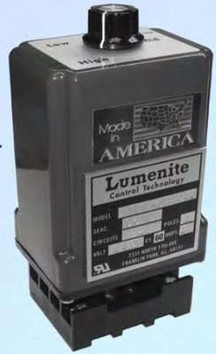

A conductivity or capacitance switch could be used to signal the presence or absence of water in the pipe and to interlock the pump in the event there's no water.
There are two components, the electrode probe that goes into the pipe,
and an electronic controller with a relay output:
The pipe must be grounded to be the other electrode in the sensing circuit.
The ones I'm familiar with are designed for level applications, where the electrode probe is inserted from the top or side of the tank. As you can see from the dimensions , the probe is several inches (55mm) long. The probe can be inserted into a Tee with a nipple and coupling to as a stand-off so that the probe can sense the water but not obstruct the flow path.
