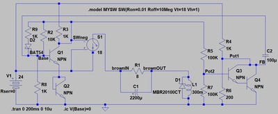

Should I put the PLC Relay switch before or after the Watt Reducer? Circuit A or B? I have 16 solenoid valves running off a PLC in a sequence. Does the Watt Reducer need to have power all the time to keep capacitor charged or does it not matter? The valve manufacturer provided the Watt Reducers but did not have specs.

The only thing I see is the possibility of a voltage spike from the watt reducer damaging the plc if the circuit is rated below the spike, so that would have to be tested and the spec found for the plc contact circuit....and also the possibility that the maintenance current is rendered too low when resistance of the plc is added to the circuit...so the operating parameter of the watt saver and the working range of the plc must both be known...or you could just put it after the plc, if the momentary delay is not an issue....
Re: Watt Reducer Circuit
08/14/2020 11:37 AM
It's worth having a quick "look" at the reducer with a meter.
I'm guessing that the blue wire will go straight through the device.
Most simplistically the brown wire will just have a resistor in series; and, a capacitor in parallel with the resistor.
If this is the case it makes absolutely no difference whether the controller contact is before or after the reducer.

Just for the heck of it I did an LT spice simulation:-
Switch before
Switch after
Waveforms with switch before
Waveforms with switch after
The Brownout wave forms (pale blue) start at 0V and 24V, but quickly become similar. The DC resistance of the inductor is 6 Ohms ( the specs. for solenoids don't seem to give a lot of relevant information) which is why the steady state voltage is just over 10V.
But crucially the current in the inductor wave forms (purple) are identical.
[I had to change the SW parameter from SW to something else (I chose 12) in the voltage controlled switch to get the simulation to work. I have no idea why.]
08/23/2020 11:32 AM
When the switch is open the only way the capacitor can discharge is through the resistor, so, you really need to leave it about 3 times the RC constant (to get to 95% of the fully discharged state) between on cycles.
However this is what the wave forms look like. I'm probing the input to the inductor in both cases.
The waveforms are identical. You can see that the first pulse is higher than the subsequent ones because I haven't waited long enough between them: this would just get worse if I made the gap shorter.
