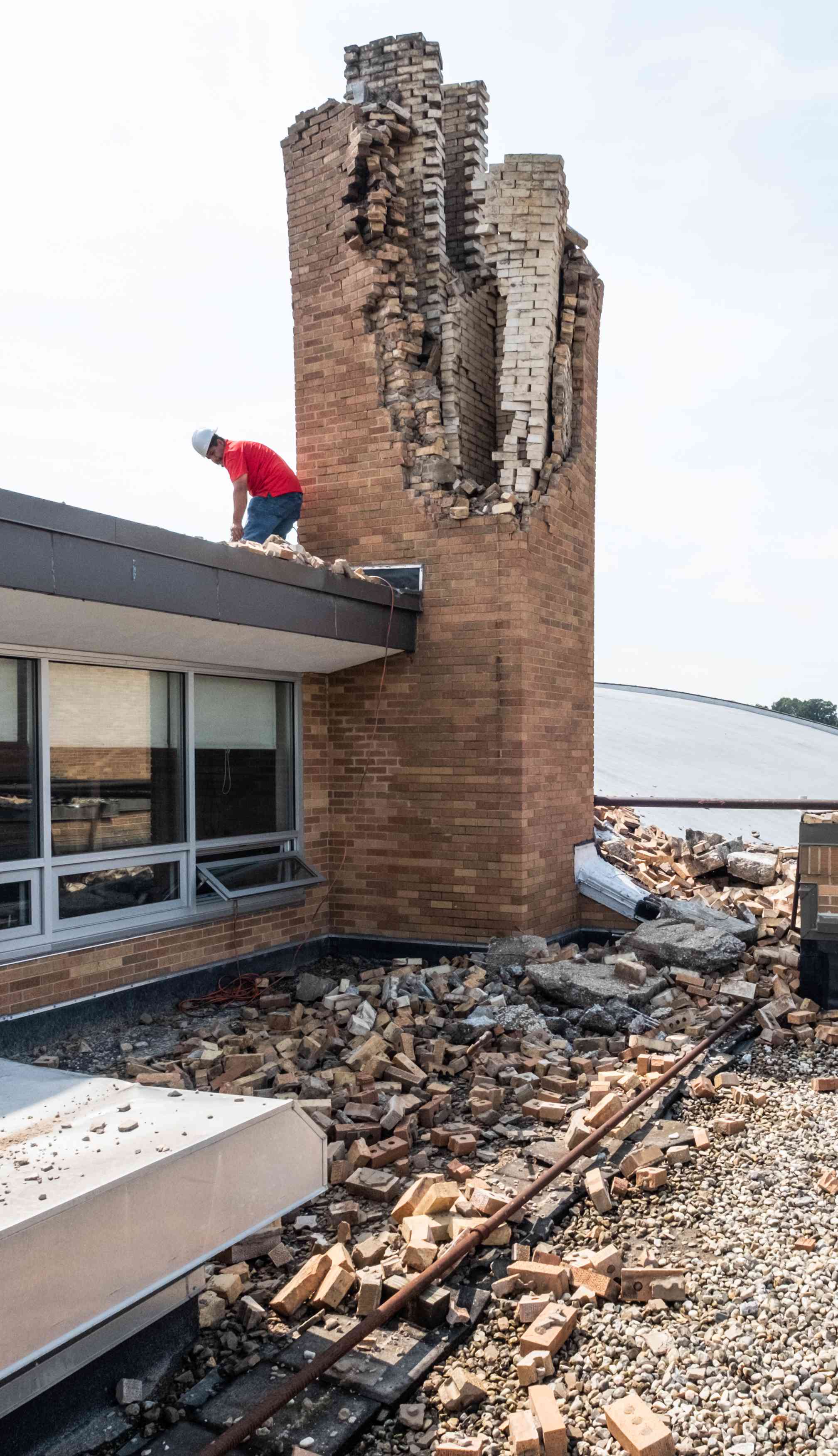

I had a customer once I was at his house and he showed me a tree on the side of the house that had been struck by lightning just the day before, well it was a bizarre sight, the trees roots that were growing just below the surface had exploded out of the ground all around the tree, and the tree had lost several branches but was still standing mostly intact, there was potholes all around the tree where the large roots were some 10 to 12 ft away and some closer, the lightning had entered the house and caused his computer screen to iridesce but you could still see what was on the screen and the computer was still working...I don't remember all the little damages there were, but it was really hit or miss...I had one customer had their A/C condenser unit hit and it reversed the polarity of both the fan motor and the compressor...I knew a guy once he had been hit by lightning and it killed every hair cell on his body and burned a hole through his watch...anything can happen when you let that much electrical energy loose, it's unpredictable.....mostly what you protect from is near misses, a direct hit and all bets are off....
Here's a tree that was struck, you can see the pattern in the ground probably from the root growth...
This guy was struck, it left burn pattern...
Here's a Walnut tree section that was struck by lightning...
Lightning struck this pin on the green...
Chimney strike...
Pretty cool shot here....
