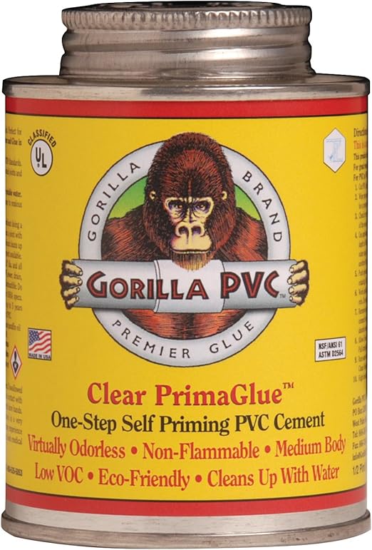

I live in Southern California and have 42 inch tall vinyl fencing. I want to know if gorilla glue will hold the top caps on fence posts Will it damage vinyl fence post material?

this IS the answer to repairing your fence. i wouldn't mess with the standard polyurethane formula. as it expands it will extrude out of the joint and if the fence is white, you will have to now try to remove the baby food color. PVC adhesive is clear and will bond almost instantly.

The vinyl manufacturers recommend PVC Glue.
I installed vinyl deck railing,and I only glued it at the corners with PVC glue.
Easy to remove if needed,but secure enough to hold in high winds.

Plastic pipe cement, for solvent-weld drainage systems.

To answer your original question, yes, you can use original Gorilla glue.
But remember, when "Polyurethane glue expands to three or four times its initial thickness, said Danielle Guido, consumer affairs specialist for Gorilla Glue. “So if you don't clamp it, it pushes the two surfaces apart.”
It will also expand down below the cap of your fence, if not applied sparingly.
