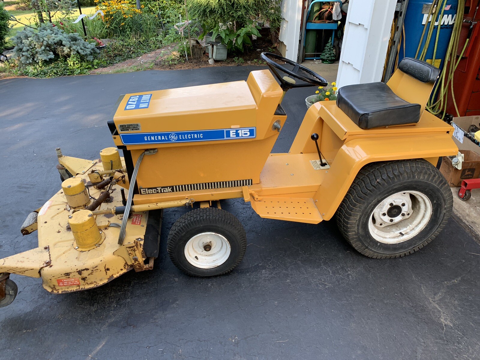

Replacing a DC Drive Motor for a GE e15 Tractor
02/01/2021 4:16 PM
Original 36 volt dc motor, 56 frame,1 hp, 25 amp 2250 rpm,if 1.9/.5,stabilized shunt.
I need to replace this drive motor, any advice on how to do a comparison to a replacement motor.
Thank you

In a situation like this where the item is vintage, discontinued and rare, it's best to buy one or two of them for parts, if you can swing it, and are that committed to having a rare and original example...you might consider having the motor rewound/rebuilt...

It looks like you have all of the necessary specs, a very complete list of all of the required parameters. From this list, you could fudge a little on the parameters, it is likely a 1750 rpm motor, with field weakening to get up to 2250 rpm. The 56 frame has variants that you may be able to get around, likely the shaft and face mount are critical to your needs. Do you not know the meaning of all of the values?

It looks like Leeson manufactures these, if you don’t mind $464 each, and buying 24 at a time...
Here is a picture that might help determine if this is what you need anyway, it is a 4 pole motor, 1750 rpm
https://electricmotorwarehouse.com/1-hp-1800-rpm-56c-frame-36-volts-dc-tefc-leeson-electric-motor-109101/
