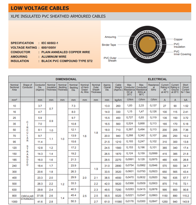

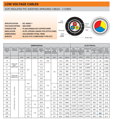

Join Date: Feb 2021
Posts: 5
Re: Size of Cable
02/10/2021 8:51 PM
Dear Mr. Rwilliams,
Thank you for you reply.
based on my understanding the inverters are 3 phase synchronized with the grid.
the THD is also between the range of grid code.
my question is when designing the cable for 2000A do we need to consider the grouping correction factor (each inverter of the 22 is one circuit)
I have attached the cable manufacturing size rating..
Posts: 1395
Re: Size of Cable
02/11/2021 1:29 AM
You will have only 4 parallel circuits, the 22 circuits are combined at your solar distribution panel. Those 4 circuits are the ones that need to be derated if they operate close to one another.
The cable is sized to carry the maximum output of all 22 inverters together.
The need for group conductor derating depends on your exact and specific method to interconnect the inverter switchboard to the main distribution bus.
The cables between the inverter board and the switchgear must run in 3 phase groups, but it is not really practical to stuff 6 current carrying conductors of that size in a single conduit, so now you just need to consider duct bank derating, i.e. 4 conduits, where you specify the spacing between conduits, the conduit material, and what they are buried in.

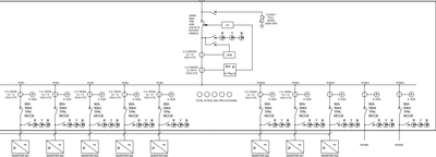

Join Date: Feb 2021
Posts: 5
Re: Size of Cable
02/11/2021 2:04 AM
Dear Mr. Rwilliams,
thank you for your valuable information.
I have attached my Single line diagram for your reference.
now I understand more about the system.
I would put anything in my degree project but I'm very interested to learn new things.
the busbars will be connected to the MCCB 4p
so now i need to consider 4 circuits depending on the gap between each other am i right?
Posts: 1395
Re: Size of Cable
02/11/2021 2:23 AM
The use of a 4 pole circuit breaker assumes you need to provide a neutral conductor, which appears to be unlikely, but may be required by local codes.
The 4 circuits you need to consider derating are the 4 parallel cable runs you need to get your peak rating. or perhaps 5, all in 3 phase groups, perhaps with a neutral, if you anticipate single phase loads directly on your distribution system. Just like the diagram, which shows 6 x 500MCM cables, which could be a link between 2 switchboards.
The derating assumes that you have 3 current carrying conductors in each group, so the derating applies only to the number of adjacent groups of conductors.
