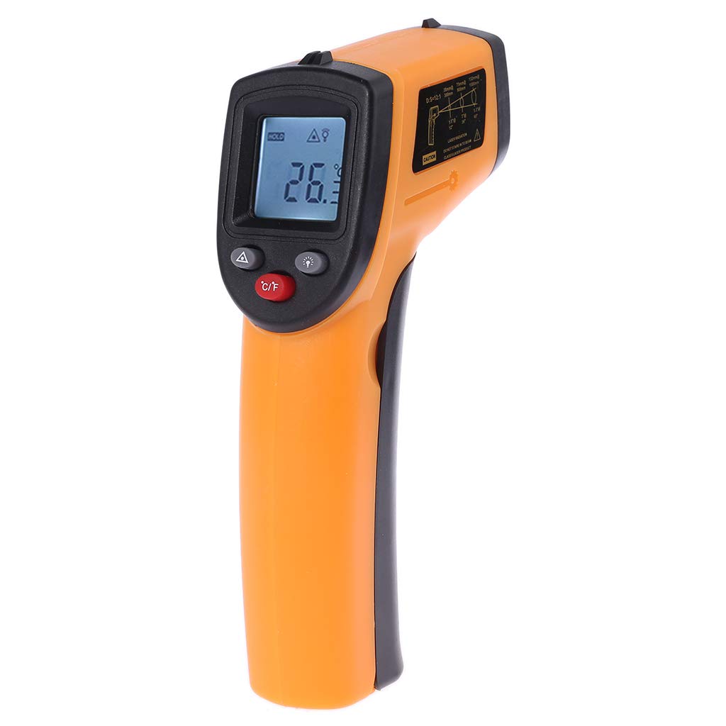

I have used Oxguard for many years,even on battery terminals.Works great,even in very hostile environments.
Non-contact temperature measurement has evolved tremendously since the '70's when an IR camera required an Argon purge cylinder,weighed about 15 pounds,and cost around $30,000.
I remember taking pictures with a modified Instamatic camera to show problems to customers.
It was like X _ray vision,showing hot connections without opening the panels.
Modern tech has made it much cheaper and simpler and saved millions of $ in repairs.
Every company should have one now.
Re: Electrical panel wires burnt out
02/12/2021 1:29 AM
You've got a bad connection somewhere it seems....I use an infrared detector for locating hotspots in electrical systems...You need to clean and connect the wiring, maybe use some cu/al or conductive grease on the connections, then energize the circuit under load and check the amp draw of each line, then the temperature of each connection point...
