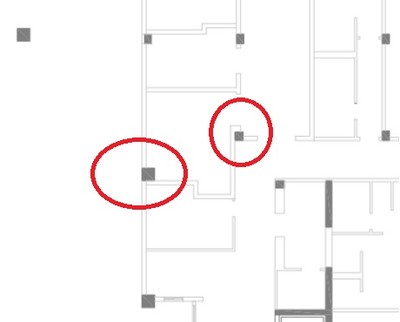

Regarding the tragic collapse of the apartments in Florida,I noticed a scarcity of rebar in the broken concrete;the upper floor patio has none visible.
The building had been settling slowly for many years,but not evenly.Un-reinforced concrete will fail explosively after it exceeds it's limit.
This may be what happened here,but there is limited information available,and I understand it is too early to determine a cause,I am just speculating on a very limited amount of info.I am sure I missed a lot.
Does anyone else see sufficient rebar in the concrete?

I don't see any rebar,rusted or otherwise, in the top floors.Plenty of conduits,water pipes,etc from each apartment,but no rebar.
I presume there is none in the lower floors either.
Slow-mo shows the collapse started at the bottom.
They could have used fiberglass reinforced concrete,but still I think in a critical job such as this,rebar should have been required,however I do not know the local building codes.
The rebar aalso has to be positioned properly in the concrete,depending on
the direction of the anticipated load.
As I stated,the building had been settling unevenly over the years,and when the torque exceeded the tensile strength of the concrete,it failed catastrophically.
The corners had the most load concentration and probably were settling more than the rest,creating an unsustainable load on the unreinforced concrete.

06/27/2021 8:19 PM
It does look like there is rebar around the support columns...
...although it does look like the placement was too near the surface....

Once the site is cleared of rubble, a close, deep inspection of the sunken foundation piers will disclose their number, their layout, their cross-section, their depth and of course their reinforcement.
A comparison with the specification values and a modern assessment of that specification must follow.
These piers are the primary source of the settlement in sand which has stressed all the above-ground materials.
