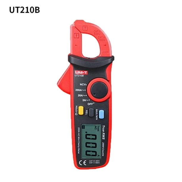

You can get a clamp-on ammeter that reads DC current. You don't have to wire it into the circuit, but it would be bigger than your thumb...
  • Be sure to get one that reads DC current. Some only read AC current.
Digital Clamp Meter Mini AC DC Current Tester Resistance Voltage Detection Multimeter, UT210B - Walmart.com
