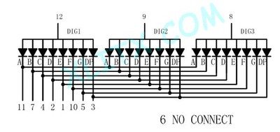

Hardware:
CL5631BW - 3 Digit 7 Segment Display
CD4511BE BCD Decoder
The BCDA inputs are wired with 680 Ohm Resistor and the outputs are wired with 680 Ohm Resistors to the 7 Segment correctly.
Problem:
All Numbers shown on the Display are inverted (All segments that should be illuminated are dark and vice versa).
I think the decoder is for Common Cathodes. Is it possible to change the mode for the decoder to Common Anode? Thank you in advance.

You are correct
The outputs of the decoder are active high
Whereas the display is a common anode device
You need to insert inverters between the outputs of the decoder and the inputs to the display.
What are you using as power rails there may be a 74 series cmos compatible decoder which is suitable (like anSN74LS47N but with LS replaced with a CMOS compatible technology).

The datasheet (see page 5) shows the 4511B wired to a common cathode 7 segment display. I think you'll either have to replace the display with Common Cathode or the driver chip with common anode.
CD4511BE pdf, CD4511BE description, CD4511BE datasheets, CD4511BE view ::: ALLDATASHEET :::
A better option (as Randall suggested) is to put inverters between the driver and display.
