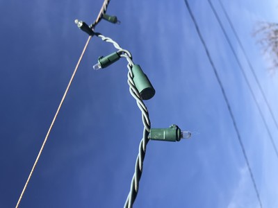

Okay, I have been around here several decades now and have seen quite a bit. This is something I have not been able to figure out. We have a string of LED lights out back on a patio powered by an Inverter on some batteries in the garage. The inverter is a 3500W unit I use for some power tools in the garage, to charge battery packs and power these string lights through a timer switch. The inverter and batteries are on a wooden cart so we can roll around the shop.
The string lights are plugged directly into the timer switch output and set to come on around 6 pm and off at 11 pm. There is a string of 150 in series with two strings of 100. They are a cool white LED. What was totally odd was a few nights ago when I was up past 11, I noticed the end section of lights were on but not the rest.
Upon closer examination I noticed that only 25 leds on this last string were on and they were not fully on and appeared to be dimmed to half brightness. No other LEDs on the rest of the string were illuminated like this. I checked the timer switch which was off, with no DC potential and 30 mV AC, measured with a Fluke 789 at the plug. When plugged into the switch the lights were glowing and when unplugged they went completely dark like the rest of the string. The 25 that were lit were the next to last 25 on the last string and were between these odd items between every 25 or so LEDs. Any idea what these plug looking items are and what would cause this odd effect to just that section of LEDs.

That looks like a plug in receptacle to me...we've had this discussion a few times on here about induced voltage generated by long wire runs next to live wires or power sources, one end has to be disconnected for it to work, so I would say that picture is the end that's disconnected, and there is some induced voltage causing this effect...ghost lights, but more properly parasitic drain....

If I read correctly, you still have 30mV across the line that is apparent AC. Remember that LEDs are diodes and so would be rectifying any AC signal that is passing through them. It could be that the combined "capacitive" effect of the strings between the switch and the LEDs that are apparently alight is enough for you to see the emitted light.
On one phase of the AC, the string "charges" this capacitor (through the LEDs) and then on the other phase of the AC the discharge current has enough power to be visible on those 25 LEDs.
Your observation that when unplugged there is no light seems to support this.

I'm guessing that since your inverter is mobile that you don't have the neutral side grounded. If that is the case, when the timer switch opens the hot side, the neutral will float up to 120 vac.
If there is leakage from one of the 25 light substrings, either through insulation capacitance or insulation damage, that could account for what you're seeing.

I'm assuming that the LEDs are designed to run on US mains, so, the absolute maximum voltage they would ever expect to see would be about 170V. Typical white LED forward voltage is between 3 and 5 Volts: so a string of 100 in series would need to see at least 300V to turn on.
I suspect that the "strings" are really 25 in series times 4 in parallel. You might want to examine the wiring especially those odd connectors more closely with that in mind.

Good observations by everyone. The Inverter neutral is not tied to ground and the timer (shown below) does only switch the hot side of the line. This timer is plugged directly into one of 4 receptacles. The only problem I have had there is this timer runs fast (gains 15 to 20 minutes a day) induced by the fact the inverter is not a true sine wave output.
the second photo is another view of the little plugs that are on the string about every 25 - 26 LEDs. I've been tempted to open one up but afraid it will get destroyed in the process, and it is the last string I have. They are sealed up and whatever potential creates the lighting effect on this last string is contained between two of these. Does anyone know what is in these?
So I think there is something coming through the neutral leg and these plug devices prevent the whole string to light. The night I saw that section lit we had rain earlier so surfaces were damp to wet.

The "plugs" are just the common ends of the parallel strings.
