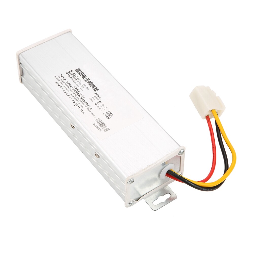

Hi folks,
I have a 72V battery, and need to convert it to 24V-10A to be used for a powered mechanical system. The DC converter should be selected to be as small, light-weight, and compact as possible, to satisfy given conditions.
Could you please recommend a good solution for the converter (model#)?

150*35*50mm / 5.9*1.4*2in

Something like this is about the size of a Hershey bar and provides up to 320 watts.
3.38 x 1.4 x 0.37in / 85.93 x 35.54 x 9.4mm
https://www.vicorpower.com/products?productType=cfg&productKey=DCM3414V75H26C2C01
In addition to heatsinking, you probably need to hang off a few parts like de-coupling capacitors and maybe some filtering depending on your application, but these are tough to beat. Do read the applications guidelines especially if there is a long run of wire between your battery and the converter.

For top quality you can't beat Vicor as Brave Sir Robin suggested.
If commercial or DIY quality are your target zone then look at Mean Well Corporation power supplies from Mouser, Digikey and various other vendors.

Search internet for buck converters. I have used a few to provide 24V or 12V from 48V or 72V UPS backup batteries to power small loads up to 20Amps. The best ones use a SMPS to chop the incoming DC, transform it, rectify it and provide an adjustable output which is over current and overvoltage protected.
Search this on ebay "dc dc converter 72v to 24v"
