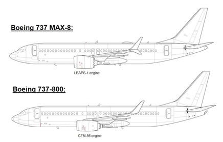

Was it a 737 Max?
Re: China 737-800 Plane Crash
03/22/2022 7:49 AM
No...
03/22/2022 10:32 AM
Thanks, a bit like a spot-the-difference puzzle!
03/22/2022 8:00 AM
Was it a 737 Max?
No, it was a 737-800, an earlier version than the max.

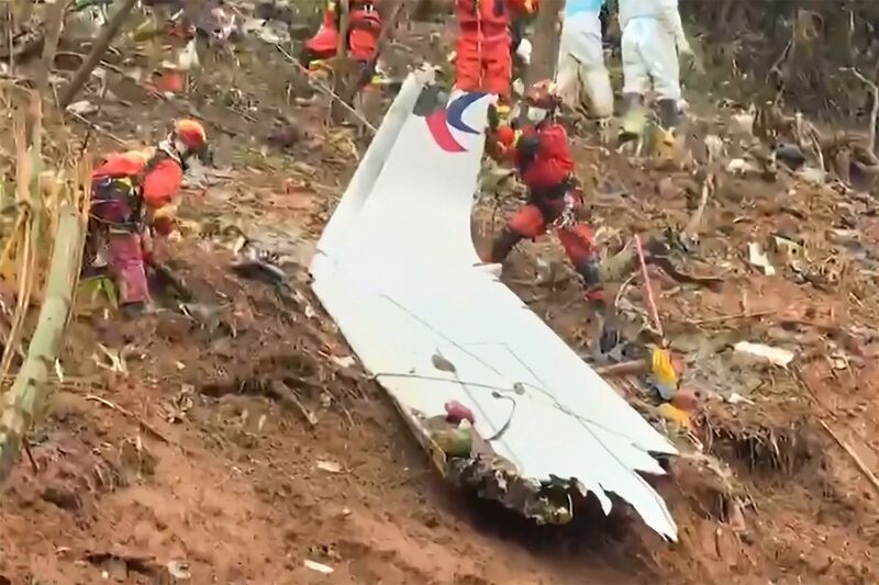

03/24/2022 8:41 PM
03/24/2022 9:07 PM
https://www.quora.com/Can-a-planes-wing-break-due-to-heavy-turbulence
That does look like a composite structure...
..."Airplanes don't constantly break because the limit or “design” load — 3.8G positive for normal category and half that negative—is not the load beyond which the airframe is expected to fail completely.
...Composite structures behave quite differently from metal ones.
Fiber-reinforced composite materials do not exhibit plastic deformation; they deform elastically to a certain point and then fail with explosive suddenness."...
03/24/2022 10:48 PM
..."Glass or carbon fibre-reinforced plastic nosecone, fairings and fin tip. "...
..."The nosecone, wing and fuselage fairings, fin tips, the fairings of the flap actuators and other non-stressed components are constructed from glass and carbon fibre reinforced plastics (GFRP and CFRP). The rear of the engine nacelles are constructed of graphite, Kevlar and glass fibre composites.
In February 2000 an advanced carbon graphite winglet developed by Boeing became available as an option on the 737-800."....
https://aviation.stackexchange.com/questions/79539/what-materials-form-the-structural-elements-of-the-boeing-737
