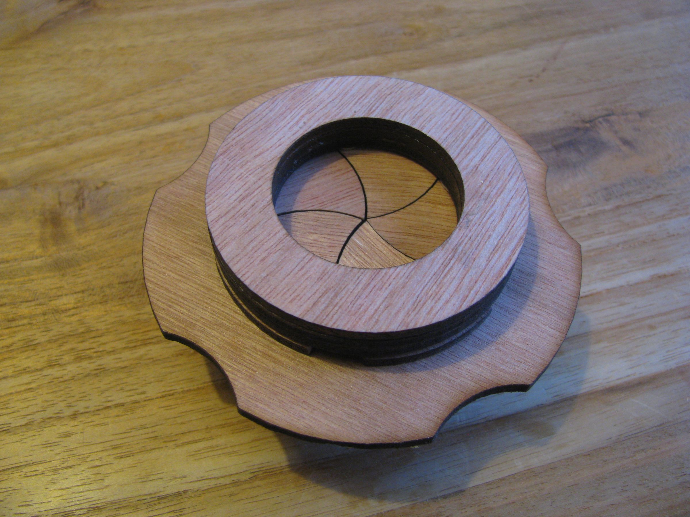

Good Morning Smart People! I'm working on a small project, a ring box. The lid is a leaf shutter, like an old camera. The body is a wood cylinder glued to the outer edge of the shutter. The bottom rotating ring of the iris is glued to a pvc tube which is glued to a wooden bottom cap. By rotating the bottom cap, the pvc tube rotates, which rotates the iris open and closed. That's the easy part.
Simultaneously, I want a plunger to raise and lower inside the pvc tube revealing the ring as the iris opens, and moving it lower inside as the iris closes. I've carved spiral grooves in the pvc tube, and put acrylic rod "ears" on the plunger to fit in those grooves. This facilitates the up and down motion. To keep the plunger from rotating along with the pvc tube, thus not moving up and down on the grooves, I've cut large windows in the pvc tube to allow longer acrylic "ears" on the plunger to reach straight vertical grooves in the stationary body of the box. This keeps the plunger from rotating, but allows for the vertical movement. This all happens in one quarter turn of the bottom cap. It works. Most of the time.
The problem is that the four points of contact on the plunger, two in spiral grooves, and two in vertical grooves are a little loose, so they don't bind, and this allows the plunger to wobble, becoming stuck in the pvc tube half way through the motion.
Am I on the right track, and need some simple tweeks, or is there a better way to make the two motions with the one turning bottom cap? Thanks in advance for your suggestions.

It is not clear why you have a large cut-out in the sides of the pvc pipe for the second through-pin. Is it not going to be following the same spiral path as the first through-pin? If so, then instead of the large cut-out, machine matching spiral slots for it. Then add two more vertical slots in the inside of the stationary outside barrel to mate with the ends of the second through-pin. Maybe this would add stability to the assembly and prevent jamming.
Join Date: Feb 2021
Posts: 30
Re: dual motion transmission for a small project
04/08/2022 1:46 PM
Wow! Now see, that’s exactly what I was looking for! I made the cut outs assuming I needed to get the pvc pipe out of the way of the longer ears. Thanks SlideWinder for helping me realize that spiral slots would accomplish the same goal. Adding 2 more vertical slots in the stationary outer wall seems to be the right move to sure up the plunger. I’ll machine a new tube like you said and report back.

These photos are of a mock up prototype. I'll make the real one with walnut wood.
I think I might have found part of the problem. There seems to be a "bump" in one of the spiral grooves, may be causing the sticking problem. I need to get some small files to smooth it out, and see if that helps. Any other thoughts would be appreciated.

- Could little rollers be fitted to the plunger ears to prevent jamming?
-Also, you write that you "carved" spiral grooves in the pvc tube, suggesting that you cut the grooves by hand. For precision, the spiral grooves should be machined - maybe a router gig to facilitate this?
-Maybe a short piece of aluminium tubing would be a better choice - it could still be router machined and it could be polished smooth - for functionality and aesthetics. Satin finished aluminium looks very nice with dark hardwoods.
-Possibly even the vertical grooves should be aluminium or hard plastic (acetal?) tracks epoxied into slots. Before that, try a bit of hard soap as a lubricant in the wood grooves.

Sorry, I failed to mention all the parts were milled on my cnc router. No hand carving. I chose the acrylic for it's smoothness as it slides through the spiral grooves. But I notice a little "give" in the acrylic, so perhaps aluminum rods might be better. You won't see any of the internal parts once it's finished, so not worried about the internal aesthetics.
I did think about lining the vertical grooves with a cut up plastic straw. It already has a natural curve, so would fit in the groove, and not pop free from the adhesive trying to hold the curve.
The hard soap is a good tip, to lubricate the parts in motion. Thanks!

It's been a while since I reported back on my project. I've finally got all the kinks out, and it's working. After making the prototype work, I made a new one out of Maple. I didn't have enough Walnut lying around.
I used Canadian SlideWinder's idea, using 4 spiral grooves in the pvc pipe, and 4 vertical grooves in the stationary wall. I'm still using acrylic rods as ears for the plunger, and I've lined the vertical grooves that receive the ends of the ears with a cut up plastic straw. The motion is smooth, and the plunger rises and falls nice and straight.
