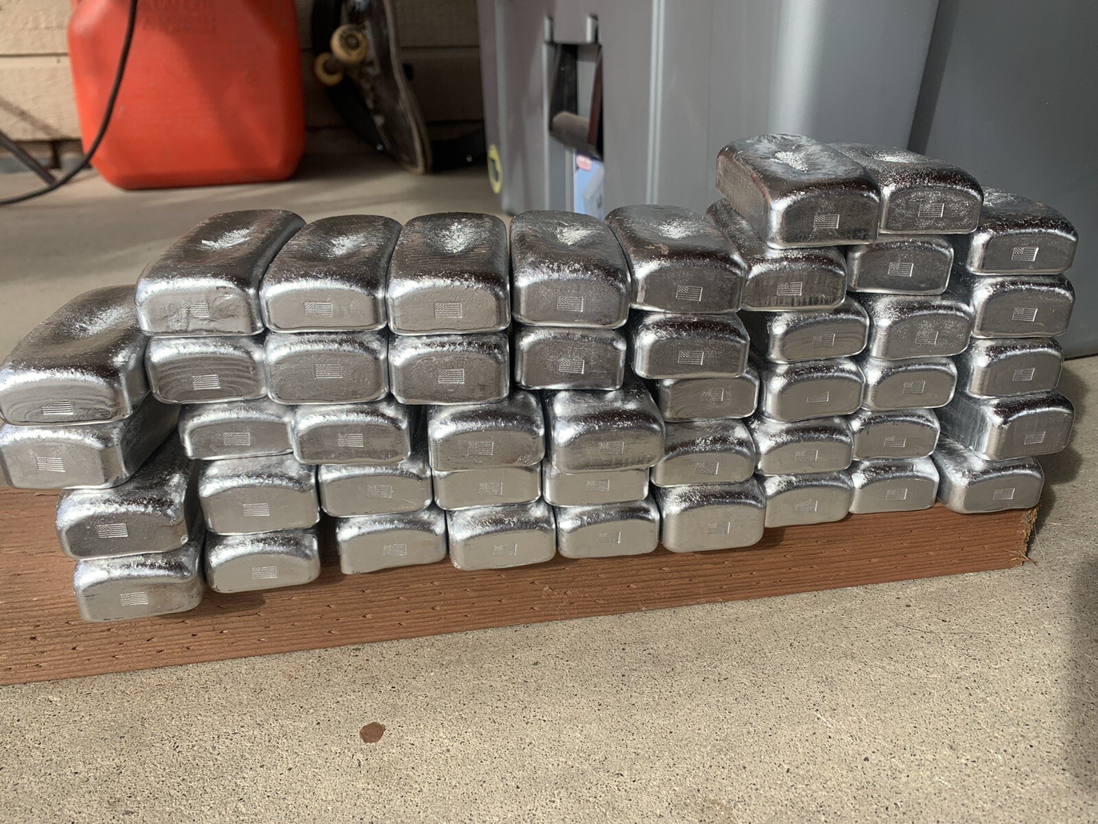

So how many PSI -- I'm not looking for a textbook number -- does it take to compress, how shall I say this, "post-consumer aluminum cans" such that they graduate from coarse slug, via a buy-the-machine-on-Amazon, to something smooth enough to qualify as sheet? I'm OK with visiting a machine shop that has, say, a 50-ton shop press. What I'm not OK with is looking really, really silly bcz the approach was DOA and they knew it.

Well, you can't just smash a can and get sheet metal out of it. The cans are smashed so as not to take up so much volume.
To make sheet metal, the cans need to be melted. Melting the aluminum requires less energy than producing new aluminum electrolytically from its ore, bauxite. The aluminum is formed into ingots and reduced to sheet metal by a series of rollers that flatten the hot malleable metal until the desired thickness is achieved.
https://www.gabrian.com/aluminum-rolling-process-overview/

What is the cost of an ingot of aluminum compared to the cost of propane used to melt the cans?
Mr.Ron from South Ms.
Re: up-cycled aluminum cans
04/17/2022 4:27 PM
Aluminum ingots on Ebay $4.50 lb.
Price of casting your own pots....priceless haha
