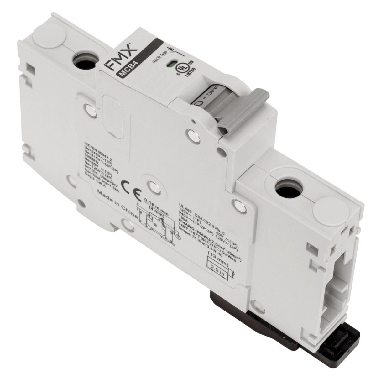

How about something like a 2 pole circuit breaker? Short in either line disconnects both lines.
Shunt trip breakers may also be workable, but I haven’t figured out how.
