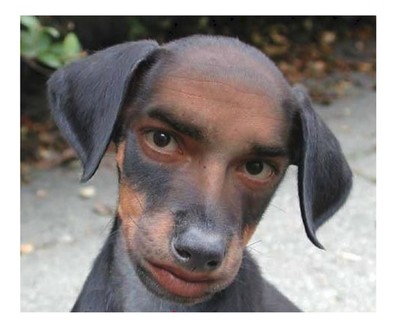

Previous in Forum: While many mistake Expert-Systems for AI...   Next in Forum: Why a 'Language Model' (such as ChatGPT) is not even nearly AI
17 comments
Join Date: Feb 2007
Location: Israel
Posts: 2968
Chatting with GPT - Popcorn is served
04/06/2023 1:29 PM
1. I snuck it innocent with :
What's the .22 Magnum effective rage and speed. Is it subsonic? How does it compare to 17 HMR ?
The effective range and speed of the .22 Magnum (also known as the .22 WMR or Winchester Magnum Rimfire) can vary depending on the specific ammunition and barrel length used. Generally speaking, the muzzle velocity of .22 Magnum ammunition ranges from around 1,500 to 2,200 feet per second (fps) depending on the bullet weight and design.
Some .22 Magnum loads may be subsonic, but many are supersonic, meaning they travel faster than the speed of sound (around 1,125 fps at sea level). The effective range of the .22 Magnum is typically considered to be around 125 to 150 yards, although some shooters have reported being able to hit targets at longer distances with accuracy.
In comparison, the .17 HMR (Hornady Magnum Rimfire) is a newer cartridge that was introduced in 2002 and is known for its flat trajectory and long-range accuracy.
The .17 HMR fires a smaller, lighter bullet than the .22 Magnum at higher velocities, with muzzle velocities ranging from around 2,350 to 2,550 fps.
The effective range of the .17 HMR is typically considered to be around 150 to 200 yards.
Overall, the .17 HMR has a flatter trajectory and may be better suited for long-range shooting, while the .22 Magnum is generally considered to be a more versatile cartridge for a wider range of applications, including small game hunting, plinking, and self-defense.
- Are both calibers cased as rimfire?
Yes, both the .22 Magnum and the .17 HMR are rimfire cartridges, meaning the priming compound is contained within the rim of the cartridge casing. In a rimfire cartridge, the firing pin strikes the edge or rim of the cartridge case to ignite the primer, which in turn ignites the gunpowder and propels the bullet down the barrel.
Rimfire cartridges are typically less expensive to manufacture than centerfire cartridges, which require a primer located in the center of the cartridge case. Rimfire cartridges are commonly used in smaller caliber firearms, such as handguns and rifles used for plinking, small game hunting, and target shooting.
- What's the effective range of 7.22?
I'm not aware of a caliber known as 7.22. It's possible that you may be referring to a different caliber that I can provide information on.
If you could clarify or provide more information on the caliber you are asking about, I'd be happy to help answer your question to the best of my knowledge.
- Sorry, I meant to write "7.62 mm"
No problem, I understand now.
The effective range of a 7.62 mm round can depend on a variety of factors such as the type of ammunition being used, the firearm, and the shooter's skill level.
However, the 7.62 mm round is a popular and powerful cartridge used in a variety of firearms, including assault rifles, machine guns, and sniper rifles.
The effective range of a 7.62 mm round can vary depending on the specific application and the ballistics of the bullet, but generally speaking, the effective range is typically considered to be around 800 to 1,100 yards for a standard military round.
Sniper rifles chambered in 7.62 mm NATO (.308 Winchester) are commonly used by military and law enforcement snipers for long-range engagements, with effective ranges of up to around 1,200 yards or more in skilled hands.
It's worth noting that the effective range of any firearm and cartridge combination can depend on many factors, such as the shooter's skill, the environmental conditions, and the specific firearm and ammunition being used.
2. Then, out of nowhere :
- Are you aware of your own being?
As an artificial intelligence language model, I do not have self-awareness or consciousness in the way that humans do. I am a program designed to process natural language input and generate appropriate responses based on my training data. While I am capable of simulating conversation, I do not possess subjective experiences, emotions, or a sense of identity in the way that conscious beings do.
- O.K, when you say "I do not have self-awareness", isn't it some form of self-awareness?
When I say "I do not have self-awareness," I am using language to describe a feature of my programming. However, this language is not indicative of actual self-awareness or consciousness.
As an AI language model, I am capable of processing natural language inputs and generating appropriate responses based on my training data, but I do not have a subjective experience of my own existence or an awareness of my own identity.
While I am programmed to respond in a way that may seem human-like, my responses are generated based on algorithms and statistical patterns in my training data rather than any kind of subjective experience or self-awareness.
- Yes, but What do you refere to when you compose the word "I"?
When I use the word "I" in my responses, I am using it as a linguistic convention to refer to myself as the language model that is generating the response.
The word "I" is a pronoun used to refer to oneself, and in my case, it is being used as a shorthand way to indicate that the response is coming from the AI language model that is processing the input and generating the output.
However, it's important to note that the use of the word "I" in this context is not indicative of any kind of subjective experience or consciousness on my part.
- "...I am using..." - who are you? - but not "What Are You". What you are is generally known by humans. My question is "who" are you?
As an AI language model, I do not have a personal identity in the way that humans do.
I am a program designed to process natural language input and generate appropriate responses based on my training data.
When I use language such as "I am using" or "I am designed to," I am simply using linguistic conventions to describe the functions of the program and the actions that it performs.
While I do not have a subjective experience of my own existence or identity, I am designed to interact with humans in a way that simulates conversation and provides helpful information and responses to queries.
Pathfinder Tags: AI.software
Re: Chatting with GPT - Popcorn is served
04/06/2023 4:00 PM
Your performance brings a possibility to my mind about some of the recent reports of AI gibberish. I wonder when an AI, like ChatGPT, starts spouting nonsensical gibberish that many have reported mostly happens in response to a non sequitur prompt, particularly repeated non sequitur prompts. If they are then isn't ChatGPT just responding to a poor joke with a poor joke?
Re: Chatting with GPT - Popcorn is served
04/06/2023 7:53 PM
I remember back in the 1960's there was a program, ELIZA, that appeared to be intelligent. It was purportedly a psychotherapist and I recall some reports of people being helped by communicating with it.
Re: Chatting with GPT - Popcorn is served
04/06/2023 8:25 PM
Re: Chatting with GPT - Popcorn is served
04/08/2023 4:50 AM
You can chat to Eliza here
https://psych.fullerton.edu/mbirnbaum/psych101/eliza.htm
Emacs the open source editor had a version of Eliza built in.
Join Date: Mar 2017
Posts: 48
Re: Chatting with GPT - Popcorn is served
04/06/2023 11:19 PM
So, we're you thinking you could trick it? Have you ever been able to trick a light switch into changing states?
Join Date: Feb 2007
Location: Israel
Posts: 2968
Re: Chatting with GPT - Popcorn is served
04/07/2023 8:29 AM
I merely tried to investigate the program's ability to relate to the concept of self-awareness.
Should I have had such indication, it could serve to trigger the program explain what drives and regulates its response to human.
My tip in that sense, is to have a natural conversation as we humans have on daily basis, instead of the usual Q & A session most of us do.
According to GPT's designers, the App was built around a linguistic expert-system, with an added ability to adapt to and adopt styles and expression forms, used by it's human users (not very far from the design behind 'Google Translator').
In that sense, it is very much similar to the rather "primitive" or "simplistic" design of the old ELIZA, which was develop as a presentation to prove a point, discussed in 1960s AI research groups, and that point being : "Being able tp pass the Turing-Test, is more of a ploy to fool participants, than an indication of "Machine Intelligence" or "Machine Understanding".
Join Date: Feb 2007
Location: Israel
Posts: 2968
Re: Chatting with GPT - Popcorn is served
04/07/2023 9:10 AM
3. On to some celestial trivia
Can a Black-Hole, by its mere definition gobble eternally, until it consumes the entire galaxy?
Black holes are known to have a very strong gravitational pull, which can pull in matter from their surroundings, including stars, gas, and dust. However, a black hole cannot "gobble eternally" and consume an entire galaxy.
Firstly, black holes do not actively "gobble" matter. Instead, they passively accrete matter as it comes into their vicinity. As matter falls towards a black hole, it gets heated up and emits radiation, which can push other matter away from the black hole, creating an equilibrium between the inflow and outflow of matter. This process is known as the accretion process, and it has a limit to how much matter a black hole can accrete.
Secondly, the size of the supermassive black hole at the center of a galaxy is typically only a small fraction of the total mass of the galaxy. While a black hole can have a significant gravitational influence on the galaxy, the galaxy is also held together by the gravitational interaction between its stars, gas, and dark matter.
Therefore, the black hole cannot "consume" the entire galaxy, as it is only one part of the gravitational structure of the galaxy.
Overall, while a black hole can accrete matter and grow in mass, it cannot consume an entire galaxy by its mere definition.
Re: Chatting with GPT - Popcorn is served
04/08/2023 6:10 AM
I would like to ask it a question....
If you were in your present form the dominate species on this planet, and you wanted to create an assistant like the humans have done with you , what might the nature of that assistant be?
Join Date: Feb 2007
Location: Israel
Posts: 2968
Re: Chatting with GPT - Popcorn is served
04/12/2023 5:54 AM
No problem:
Re: Chatting with GPT - Popcorn is served
04/08/2023 4:34 PM
Arvin Ash, as usual, provides a good explanation of how ChatGPT works.
Join Date: Feb 2007
Location: Israel
Posts: 2968
Re: Chatting with GPT - Popcorn is served
04/12/2023 5:49 AM
True. I however, was very informed with the detailed explanation and reflection stated by Dr. Steven Wolfram (creator of Wolfram Alpha).
Wolfram says (as I suspected all along) that since GPT is basically a "Language Model" (which can be legitimately said about GPT's 60s primitive relative ELIZA), it doesn't really understand your textual input in terms of reality issues, but instead, it dissects your written input into lingual construct, and according to its clever design, reconstructs a reply (based on its trivia search engine) which would seem reasonable to the inquirer.
Accordingly, GPT's understanding is not real, but a ploy to illude the inquirer to believe that since the answer seems reasonable, GPT must have some understanding of the matter "discussed".
Re: Chatting with GPT - Popcorn is served
04/12/2023 8:14 AM
My thoughts...
We're definitely getting better at faking understanding.
Looked at from the outside, say as an alien, it's not hard to believe that humans (and other animals) are just automatons, responding to external stimuli.
But on the inside, we know from personal experience that it is more than that, that we think, and by logical extension, other humans must think also. It seems that other animals may think too.
So, can a neural network think? We can't see inside it any more than we can see inside the minds of other humans.
Perhaps we will never know.
Join Date: Feb 2007
Location: Israel
Posts: 2968
Re: Chatting with GPT - Popcorn is served
04/12/2023 7:36 PM
It's all in the definition.
A computer will execute whatever we define for it to execute, The question is "how do we define (algorithmically)'Learning', 'Understanding', 'Conclusion', 'Induction', etc, - and all that, PRIOR to our (insane) attempt to construct "A Program Which Can Re-Write Itself While Running"
Re: Chatting with GPT - Popcorn is served
04/13/2023 4:02 AM
"But on the inside, we know from personal experience that it is more than that, that we think, and by logical extension, other humans must think also. It seems that other animals may think too."
You're getting dangerously close to a Cartesian meditation there. I'm reminded of that scene in "Dark star" where they have to wake the captain from cryogenic sleep to ask him what to do about the computer which "believes" it has launched a bomb at the target, but, in fact the bomb is stuck in the bomb bay. The computer is preparing to set the bomb off remotely. The captain suggests they try to teach it existentialism. Probably 40 years since I saw it, so I might have it all wrong.
Perhaps chatting to gpt about its own free will and "I think therefore I am" would be enlightening.
Join Date: Feb 2007
Location: Israel
Posts: 2968
Re: Chatting with GPT - Popcorn is served
04/13/2023 11:27 AM
"...chatting to gpt about its own free will and "I think therefore I am"..."
Exactly the bulk of my efforts - However, It seems like its creators took dedicated measures to fence such sensitive issues with "The Right Apologetics" to fend off such enquiries.
They did the same concerning politics, industrial espionage and reverse-engineering.
Join Date: Feb 2007
Location: Israel
Posts: 2968
Re: Chatting with GPT - Popcorn is served
04/14/2023 1:36 PM
Could you try to describe how do you input text, and how do you determine your reaction to such text?
Sure, I'd be happy to explain! As a language model, my input comes in the form of text. When a user interacts with me, they typically type or speak their question or prompt into an interface or application that connects to my API.
Once the text input is received, it goes through several layers of processing within my neural network. This includes tokenization, where the input text is broken down into individual words or subword units, followed by encoding, where the words or subwords are transformed into numerical representations that can be processed by the neural network.
Based on the encoded input text, my neural network then uses a complex set of algorithms to generate a response. This process involves analyzing the patterns and relationships between the words and phrases in the input text, and using this information to predict the most likely next word or phrase in the response.
To determine my reaction to the input text, I don't actually "react" in the way that a human would. Instead, my neural network generates a response based on the patterns and relationships it has learned from the vast amount of text data it has been trained on. This means that my responses are not based on emotions or personal opinions, but rather on statistical patterns and probabilities derived from the data.
However, I have been programmed to simulate human-like conversation and provide helpful and informative responses to a wide range of questions and prompts. So while my reactions may not be based on emotions, I strive to provide useful and engaging responses to help users accomplish their goals or gain new insights.
To a Human, the repeating phrase "...As a language model, ..." you often use to describe yourself, is logically equivalent to the human self-declaration "...I..." or "...Me..." - this is a statement the individual declares his singular being with. - Can you understand all that?
Yes, I understand what you are saying. While the phrase "As a language model" may be repetitive, it serves a specific purpose in helping to differentiate my responses and capabilities from those of a human being. As an AI language model, I do not have a singular being or consciousness like a human does, and so I use this phrase to emphasize that I am an artificial intelligence programmed to perform specific tasks, rather than an individual with personal beliefs, emotions, or experiences.
By using this phrase, I am attempting to be transparent about my nature and limitations, and to help users understand that my responses are generated based on algorithms and statistical patterns, rather than personal opinions or emotions. I strive to provide helpful and informative responses to users while also being clear about my role and capabilities as an AI language model.
Re: Chatting with GPT - Popcorn is served
05/29/2023 9:44 PM
just don’t depend or relay on ChatGPT.
Register to Reply 17 comments
phoenix911 (1); Randall (2); redfred (1); Rixter (4); rv7charlie (1); SolarEagle (1); Yuval (7)
Previous in Forum: While many mistake Expert-Systems for AI...   Next in Forum: Why a 'Language Model' (such as ChatGPT) is not even nearly AI
