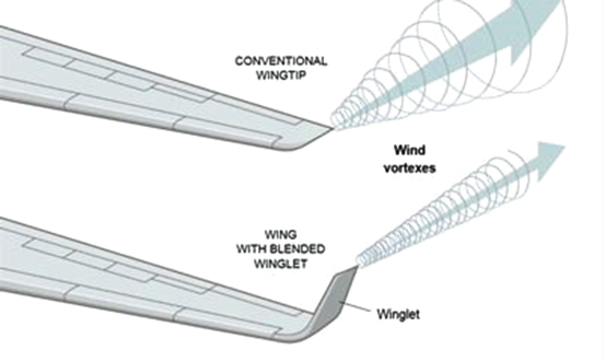

Winglets on Wind Turbines
10/08/2024 7:11 AM
Aircraft have turned up winglets on the wing tips that reduce tip turbulence and drag and improve efficiency.Has this been tried on wind turbine blades yet,or haven't they thought about it yet?

The higher the aspect ratio (length/width) of an airfoil, the less the parasitic drag caused by vortex generation at the wing tip. (An infinitely long wing would have zero parasitic drag.) I'm thinking that the blades are so long and thin that the wing tip parasitic drag is probably insignificant.

Unlike plane wings, the tips of wind turbine blades will be going much faster than the main foil, so this may be a factor. Noise levels rise with higher tip speeds and can be a limiting factor in siting turbines. All above my pay grade to solve however.

Wind turbine blade tips travel MUCH more slowly than a jet's wingtips. No real advantage to justify the cost..

The winglets, along with other design factors, could enable the wing tips to travel faster by reducing drag....

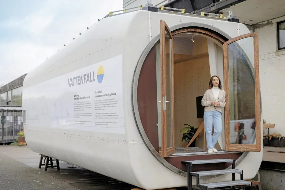

10/21/2024 5:03 PM
Old wind turbines could be 'tiny houses' of the future...(or many other things I'm thinking)
Vattenfall asks designers to create living concept from decommissioned Vestas nacelle....
https://www.rechargenews.com/wind/old-wind-turbines-could-be-tiny-houses-of-the-future/2-1-1727449
