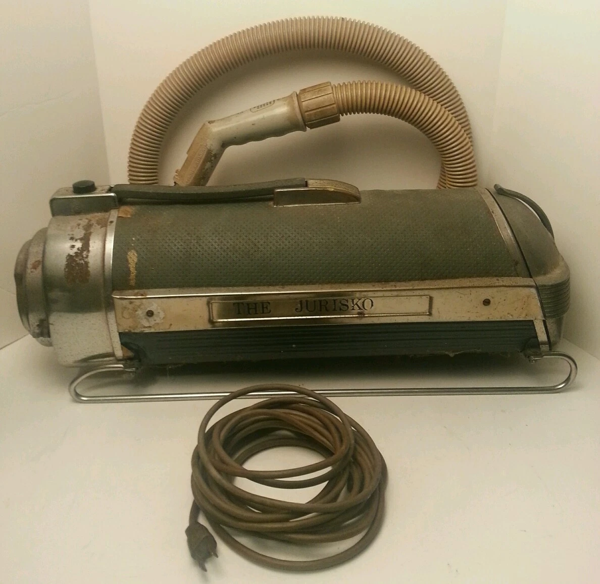

Probably the remnants of a supernova, many light-years away. That is, if you were driving East at the time. If you were driving North, then it was Mildred's old Electrolux vacuum cleaner.

That looks eerily similar to my portable jet-pac.
