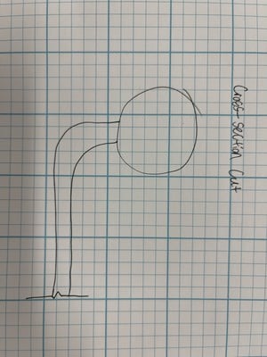

Hello,
I recently started an internship at a water resources civil engineering firm. I'm assigned to a project where we are designing a buried pipe to replace an irrigation canal. The client asked us if we could design the pipe where branches would come out of the bottom of the main pipe and then extend out to their respective retaining ponds (see my basic sketch of the pipe cross section). The reason for this request is that no matter how little water is in the pipe, the water can always flow into the branch. My colleagues are unsure of the validity and constructability of such. Has anyone tried designing or constructing a pipe in such a way?

Taking the branch pipe out at the bottom of the main pipe would be a maintenance problem. It would serve the same purpose to take the branch out horizontally from the bottom of the main pipe. This would be more serviceable.

You need to allow for sediment buildup, especially in places of low velocity. It seems unlikely that you will be assured of enough velocity to keep solids suspended in the flow.
In the example you sketch, a sudden influx of flow could collect and deposit the sediment on the bottom of your large pipe into the bottom exit lateral, plugging it unexpectedly.
It is possible to design a tapered header where the velocity stays fairly constant through a flow range.
If you consider constructibility, a bottom exit pipe will be hard to fit and backfill so that the large pipe is supported evenly where the weight is greatest. Settling will occur as the pipe is filled. The design will need to account for this.
If unavoidable, then means to clean these collection areas should be designed in. Flush ports can be a common addition to such a design, brought to an accessible location for jetting out the line. Means to dispose of the sediment also needs to be considered.
Large pipes can transport significant weights of liquids, which can result in destructive forces if the liquid is stopped suddenly. This is significantly more dangerous in a closed pipe than an open topped channel.
Suddenly, a seemingly simple drain can become a complicated design problem.

5: Without the relative dimensions of the Main / Pipe Outlets but my suggestion would be locate your "branches" on the side / upper half of the main pipe so you avoid the need for Access traps to clear any sediment build-up, especially if the water is not constantly flowing!

Since a closed pipe will be difficult to clean, a trash rack and screen is often included in such installations.
Perhaps the lateral exit pipes should exit at a slight angle back from the main pipe, so that a stick or object transported by the main flow would have to turn slightly upstream to travel down the lateral. I think that distribution pipes near the bottom of the main pipe should be adequate to ensure distribution during low flow. This would imply that your main pipe was level over the entire 4 mile length.
Of course, the first pipes will accept all of very low flows, leaving the downstream pipes & reservoirs wanting. If the reservoirs are all constructed to have matching bottom elevations, then the distribution should equalize reasonably well, proving the upstream consumers don’t consume their delivery in a short time.
The conversion to a closed system should make it easier to keep clean, especially from outside sources.
The sizes you mention seem reasonable for most any common materials of construction. (concrete?)
Having reservoirs at the ends of your distribution will provide another settling point for debris, and provide a buffer for periodic irrigation demands, smoothing delivery of water to the crops.

Irrigation on an orchard may already have filters and some sedimentation will also occur in the pond and the water in the pipe will also be cleaner than the water in the canal.
My concerns would be
The flowrate of the outlet - it should also be limited to what the pond can handle. In a canal system the flowrate is restricted by a weir or something.
It is not ideal to at some stage require the full flow to go all the way.
The second concern is that if the big pipe is trenched at 6 ft an 8" bend may add another 2ft and it will be deeper than the existing outlet pipe.
