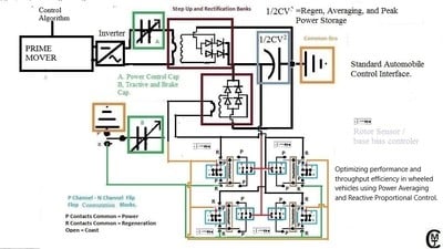

Would a car with a gasoline engine that’s running at its most efficient RPM that’s running a generator that drives the wheels be more efficient than a combustion engine with supplementary battery power?
US trains do not run on batteries because they run on electrical power produced by a generator which is in turn powered by a diesel engine which keeps the generator powered up and the generator powers electric motors that mechanically drive the wheels.
The big advantage of a diesel running a generator loco over a diesel only loco is that the generator is constantly run at it’s most efficient RPM, taking advantage of minimum fuel used while giving maximum energy, thus making it more efficient than a diesel only train which has to vary its RPM as the load varies.
So, would a car with a gasoline engine that’s running at its most efficient RPM that’s running a generator that drives the wheels be more efficient than a combustion engine with supplementary battery power?
Forget about the noise of an engine running at its most efficient RPM, how to work out in theory which one is the most efficient, the combustion engine with supplementary battery power or the constant RPM engine that’s driving a generator that drives the wheels?

First of off, the comparison to a diesel electric locomotive is a red herring; as an example, an automobile would have no use for an immense air compressor like a train has.
Now we have the comparative phrase ‘more efficient’. More Efficient as in fewer dollars spent over the total miles traveled? More Efficient as in fewer episodes of maintenance, and fewer, less expensive parts? More Efficient as in fewer gallons of fuel consumed over useful life of vehicle, disregarding other equipment and operating expenses?
It is my belief that, in whichever metric of efficiency you use, an ICE spinning an alternator that in turn powers hub motors vs. a common ICE and mechanical transmission, the electric motor scheme will be less efficient every time.

Not sure how to quantify the losses in an "electrical transmission" and a mechanical transmission. I'm sure a locomotive engineer could expound upon that. And like you say, mechanical things have a level of complexity and wear issues, but electrical drive trains have wear-out considerations as well but in a different kind of way.
The Wikipedia page has a detailed description of the power train in a modern diesel-electric as well as brief descriptions of legacy designs. It's worth a quick read.
https://en.wikipedia.org/wiki/Diesel_locomotive
Essentially the powertrain is a diesel engine driving an AC generator with a controllable field, and then a rectifier feeds the DC link and then a variable frequency motor drive (inverter) produces current for the traction motors on the trucks.
Looking at the efficiency losses, we have: (ignoring the losses in the engine as common to both configurations)
1) The AC generator: ~94%
2) The rectifiers: ~97%
3) DC Link losses are probably negligible: ~99%
4) The variable frequency motor drive (inverter): ~92%
These are just spitball numbers from various sources, some of which are from my background with some of these technologies, but this just gets us in the ballpark.
I'm going to guess that the power train efficiency of a modern D-E locomotive is going to be about 83% efficient. Mechanical systems can be more efficient, but probably don't adapt to the wide range of torques and speeds of an electrical drivetrain where you can generate enormous torques at low speeds and also efficiently run at high speeds as well. The cost and complexity of such a transmission would be substantial.
For a car that has a fairly narrow torque vs. speed operating band, a mechanical transmission with a helper motor/generator (standard hybrid) is probably more efficient than a car that has no mechanical energy transmission between the engine and the traction motor(s).

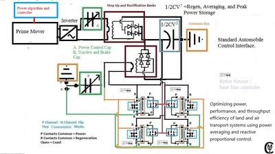

I am confident such hybrid power processes are currently being put in tanks and military vehicles while already widely used in marine applications.
I am confident such hybrid power processes will be applied to bicycles, autos, trucks, and airplanes in the future.
When it comes to power, how it is produced takes a back seat to how it is processed.

"the electric motor scheme will be less efficient every time."
Why?
Perhaps a single well aligned chain and sprocket, but multiple mechanical conversions? Even with the extreme high efficiencies of transmissions, some claiming to be more than 90%. That conversion is not the only mechanical conversion that takes place between the prime mover and drive wheel.
In power by wire auto application, where the wheel is the rotor, there are neither mechanical nor directional conversions.
Granted, electric power control can be lossy, but as materials and methods advance that will change.
Electric motors also lend themselves well to regeneration, more so than mechanical and hydraulic systems?
