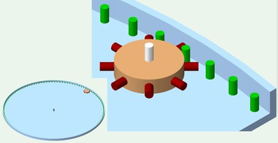

Good answer, DKW, and it leads me to MY question. I am designing a turntable for a lady's group in my church, which, if successful, will most certainly see much more than the planned use. It needs to turn at about 1 RPM, the table is roughly 40 inch diameter, I can apply power at any point along the rim, or underside (so actual track diameter is more a function of available torque and calculated speed of rotation), and the whole thing, battery powered, needs to be able to "turn" a load of about 40 pounds. That's the current spec. Specs may change later, as it sees use.
I managed to purchase a "lazy susan" bearing ring set with a 1000 pound load capacity (way in excess of requirements, but inexpensive, and much better made than anything available from people like Williams Sonoma, or even Home Depot or Lowes.
So, I found a motor, with a large reduction ratio, and according high base RPM (no load, no gear motor speed). It is probably as inefficient as you all have said, but I could live with that. What I can't live with is the growl of the assembly, both that which is mechanically coupled to the turntable by the friction drive I tried, and that of the motor/gearbox assembly. I MIGHT be able to live with the motor/gearbox noise, but would prefer lower speed/more efficiency for longer battery life.
In addition, at least for version 1.0, it has to be low cost (I have about $120 dollars of my own in it now, and was castigated thoroughly by the young lady who asked me to design/build it, and who I babysat when she was 2-3 years old and her Dad and I were fishing buddies, for spending money I can't convince her I could afford), and it has to be fairly light weight. The current assembly weighs about 25 pounds and if it goes up much, the ladies won't be able to set it up when they need it.
Assuming, (and knowing the history of MY 38 years with this church, I'm certain it's a good assumption) this THING finds more widespread use, all those specs might change. But then, so will the funding, storage requirements, etc., and MAYBE someone else will do the redesign anyway. Then it will all be their problem.
Any advice you can give me for power sources? I'm about tapped out, after 6 months of online and local research. And I have several HD, Lowes, and Ace Hardware, as well as Hobby Lobby, and many unaffiliated hobby stores I've visited and checked with. I've also checked some of the available Used and Surplus parts sources in print and online, but I'm certain there are a lot of which I'm unaware.
Anybody wish to weigh in with advice? I'd most appreciate it. If necessary I'll move this to another thread so I don't hijack this one. Though this does appear to be a similar trail.

Obviously I have no idea of what machine tools you may have at your disposal, but one low-cost possibility that comes to mind would be to drill a series of equally-spaced holes close to the rim. These holes could be driven by pins in a small gear-like pinion, or they could hold pegs that are driven by the pinion. At 1 RPM, these should be virtually silent.

Thank you. I've seen the pin drive idea, but couldn't find a photo. Your description gives me enough to work on, so I'll try it. The Smithsonian used to have a whimsy Machine in their Air and Space art gallery with a silent string driving a 20 foot diameter table, but it's apparently in storage now where I can't study it. It would have worked well too. But its reduction ratio had to be on the order of 2000 to 1, or so, and it's applied torque was so low I saw a toddler stop it with his fingers once (his parents weren't watching). It took a good 5 minutes to get back up to speed , so it had to also have horrendous slip at that ratio with a friction drive.

I had to try it...
Here's a bottom isometric view of one possibility, with a detail:
Here, the table is 40" in outside diameter, with a 1/4" thick rim and top. The table pins, in green, are 1/4" in diameter and 3/4" long, with 1/2" exposed. There are 120 of them, at 3.0° spacing, on a 39" diameter circle.
The drive wheel is 2" in diameter, with 8 - 1/4" pins @ 45° spacing, each extending 0.4" beyond the disc. The drive wheel center is 18.3" from the table center.
This will give a 15:1 speed reduction from the drive wheel to the table.
I could provide more details if needed.

Thank you. Provide more detail? I think not. That would remove my excuse for not starting right now. And since I'm in the middle of a move, I have to wait till later. So I'll get back to you on it, and my thanks.
