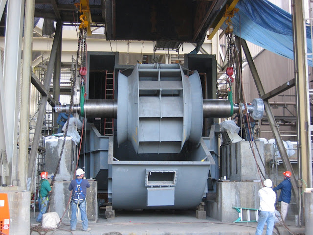

Previous in Forum: DIN 17176 Filler Metal Handbook?   Next in Forum: Query Regarding Material for Plate of Iris Diaphragm
8 comments
Anonymous Poster
Maximum Flow Rate of Electric Blower?
08/12/2010 2:50 AM
what is the maximum flow rate that can be obtained from any electric blower ?
Re: ELECTRIC BLOWER
08/12/2010 2:57 AM
However large the current maximum is, surely something yet larger can be designed.
Anonymous Poster
Re: ELECTRIC BLOWER
08/12/2010 3:01 AM
currently what s the maximum ?
Re: ELECTRIC BLOWER
08/12/2010 3:19 AM
Elephino.
Re: ELECTRIC BLOWER
08/12/2010 4:13 AM
My previous post was a bit facetious. The largest blower I have ever been involved with was an 1800-hp VFD-controlled fan for an icing wind tunnel (with three 750-hp screw compressors for the refrigeration). We didn't get the job, and I'm not sure anyone did.
As a rough guess, I would imagine that 6000hp (~4500kw) is about the largest available blower/fan, but I don't really know. It will be interesting to receive other input on this.
Join Date: Aug 2006
Location: Western Australia
Posts: 767
Good Answers: 58
Re: ELECTRIC BLOWER
08/12/2010 7:13 AM
The under construction Medupi coal fired power station in South Africa has ordered 10.4 MW motors for their ID fans and I am sure these are by no means the biggest around.
Not sure how the OP defines a "blower" though.
Re: Maximum Flow Rate of Electric Blower?
08/13/2010 8:16 AM
Mach 1.0.
Anonymous Poster
Re: Maximum Flow Rate of Electric Blower?
08/17/2010 3:44 AM
Not a flow rate.
In theory maybe, but Mach 1 for a centrifugal blower would be most unlikely - the stresses at the periphery would be enormous. They are usually pretty low speed machines.
Location: WTF Pacific Island
Posts: 14
Re: Maximum Flow Rate of Electric Blower?
08/15/2010 12:48 AM
Below is a fan driven by a 10,000hp VFD motor being installed.
Reply to Forum Thread 8 comments
Anonymous Poster (2); krush (1); PWSlack (1); The Prof (1); Tornado (3)
Previous in Forum: DIN 17176 Filler Metal Handbook?   Next in Forum: Query Regarding Material for Plate of Iris Diaphragm
