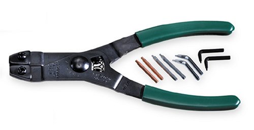

I am not familiar with the iron in question. I Googled "Morphy Richards Steam Iron Image" but could not come up with an angle that showed the size of the screws.
Based on your description can you use a tool like this or similar to this:
Or can the screw heads be grasped with a small pair of needle nose vise grips like these:
Good luck with the repair!

I think I know the type of screw you're talking about, but I don't think you'll find a head that fits them. They don't want you to take it apart, they want you to buy a new iron.
These screws are probably buried in holes in the iron body. You may be able to drill out the solid part in the center and use a small screw/bolt extractor to get them out, then replace with standard screws when it's fixed.

Sound like a spanner which can two small holes or slots at opposite ends.
