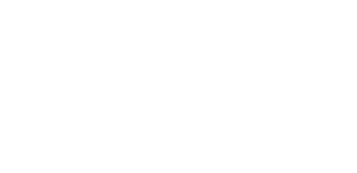

Here are the schematics of a 4 input/4 output amplifier circuit (link: http://www.zen22142.zen.co.uk/Circuits/Audio/quad.htm) to which I'm trying to connect this equalizer circuit (http://www.zen22142.zen.co.uk/Circuits/Audio/3band.htm). Is it necessary to build one equalizer for each input, or can I build only one for all of them? And how can I do it properly? Thanks in advance!

It is not necessary to build any equalizer circuits at all. But if you want all four channels to have an equalizer then you will have to build four equalizers. Now it will get a little tricky to make four equalizers that must have identical equalizations. You could do this with a motorized potentiometer or a common voltage controlled potentiometer. It's all up to you about what you want.

Ok I'll bite, why would you want to add a graphic equaliser to an amplifier capable of 2000mW (2watts)a channel?
How about just a simple tone control instead (one per channel)?
Like this;
If you use dual potentiometers grouped as Front and Rear you'll only need 4. 2 for bass and 2 for treble.

Yes, if you want to adjust the equalization for each channel, then you need to replicate the tone circuit four times.
Personally, I would be weary of that tone circuit. 20 dB of boost and cut on each control will most likely be difficult to live with in reality.
First, the idea of ±20dB of adjustment in the mid is ridiculous. ±5dB would be much more usable.
Second, without either simulating the circuit in Spice or building it and trying it, there is no way to really know if and where "flat" exists in the EQ. Many times circuits like this do not EQ flat when the controls are centered and sometimes it is impossible to get a flat response.
Third, the input to the EQ is unbuffered. This means that different input impedances will alter the tone circuit somewhat. Again, you need to simulate the circuit to see what is going to happen or add a buffer amp at the input and make it a truly active set of controls.
The pots should be linear. As Redfred noted, finding 4-ganged pots is not going to be easy.
