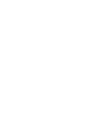

It is steam double flow reaction turbine.hot well condensate conductivity is high due to tubes rapture. We could isolate one chamber at 75 % electric power and also drain one chamber and open it. Now problem it that how can detect, which tube is rapture. Please tell me. Thanks.

Isolate the steam side, open-up and and inspect the tube headers with the water side under pressure. Whichever tube is leaking will show up as water pi$$ing out of it.

this is good method for preventative but i need online method in normal operation.

ECT and IRIS are good methods, but it's not on-line method you want. ECT I got it done for some coolers, it's a method to measure remaining tube thickness and compare with original, so that failure could be predicted in advance. It is done off line, because a probe has to be inserted one by one in each tube after thorough cleaning.
Also, it seems you have not defined your problem properly and discussions went off-line to detect which tube has failed? I think you wanted to know that tube of which chamber (out of four) got ruptured, while in operation? Am I right?

I've worked with a number of power plants using helium leak detection to isolate leaks. However, your schematics are not clear enough on the site for me to understand what you are trying to do. Do you have more detailed pictures you can post?

The method mentioned by jsmclaren (helium) is used in a vacuum system to locate leaks. The method involves sensing the gases at the air ejector vent, the helium is injected at a known area and sampled almost instantly.
I don't know if it would work in your application, there are a lot of vendors out there check with one. It is simplistic and effective for normal vacuum leak problems.
