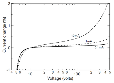

Kindly send me details as how to make milli amps Source and what is the Range upto I can Source?

Are you asking about a current-source calibration box, with various currents available, like 1, 2, 5, 10mA, etc.? As far as the values that are available in current-source instruments, the sky is the limit. For example, you can readily get Source-Measure instruments, often called SMUs, with 10A output ranges, and currents to hundreds of amps are common.
A Keithley 2601 can be programmed to deliver any current from 1pA to 1A to your load, while measuring the resulting voltage across your load. It has a 40V headroom, or compliance capability. A Keithley 2611 has 200V compliance, and can deliver up to 10A pulsed, with 5V compliance (that's 50 watts). When we talk about current sources, an important specification is the maximum voltage-compliance range. So if you simply ask about a current-source Range, one may be uncertain whether you're asking about its voltage-compliance capability, or the maximum currents available.
Let's say we take your question literally, you'd like to make a milliamp source, I = 1.0mA, and are asking how much range, or voltage compliance it can have. You can easily make such a source with 450 to 900 volts of range, assuming you have a high-voltage DC power supply to run it. I say easy, because it requires only a depletion-mode MOSFET, with one added one resistor, or more accurately, a resistor plus a trimpot so you can calibrate it.
Depletion-mode means the part is turned on with no bias, and you have to take the gate negative to throttle down or turn off the current. (This contrasts to the more common enhancement-mode MOSFET, which is normally off, and requires a positive gate voltage to turn it on.) Like tubes in the old days, depletion mode parts can be self-biased, and this makes them well suited to make simple current sources. Now instead of the gate going negative, the source is going positive with respect to the gate. Hah, the MOSFET doesn't know the difference.
A favorite part of mine is the Supertex LND150, which is in a 500V n-channel part available in little TO-92 or SOT-23 packages, or in a SOT-89 power case. But even in the power case, it'll suffer from excessive junction heating, with resulting VGS and IDS changes, as power levels exceed 250mW.
A better-suited part would be an IXCP10M45 from IXYS, in a TO-220 power package, $1.68 from Mouser. This looks like a depletion-mode MOSFET, but is called a current regulator by its manufacturer. Its performance from VDS = 5V to 450V is quite good, as the graph below shows, better than 0.1% for 0.1mA and 1.0mA current sources. At 10mA the effects of heating (4.5 watts at 450V) are becoming pretty noticeable.
There's also an IXCP10M90S available, rated at 900 volts. It costs $3 at Mouser.
So one answer to your mA source Range question could be 450 to 900 volts. :-)
