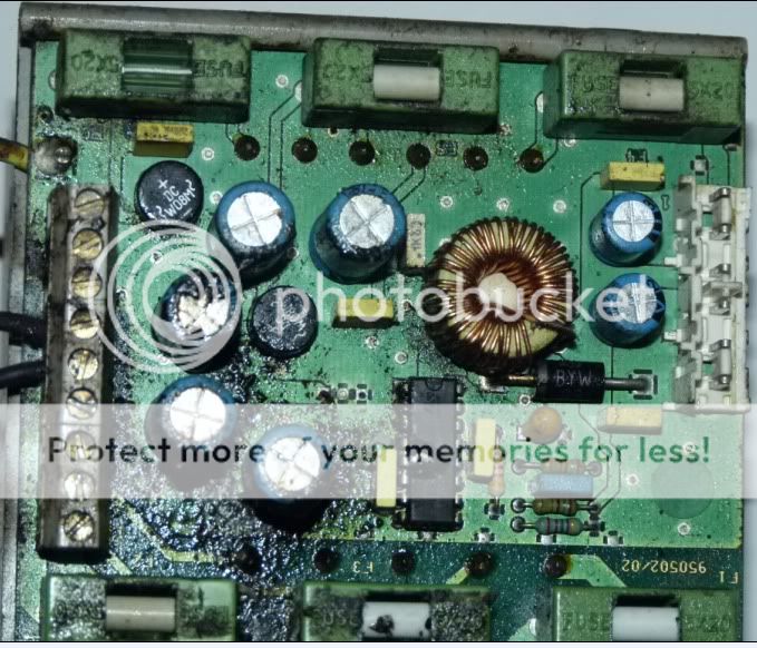

the photos attached are of a power supply board from a Hobart Combi Oven
It has a hole in the IC pictured where the magic smoke has escaped.
I cant read all the numbers on the IC . any suggestions to identify the component so i can replace it with an equivalent ?
The numbers i can see are _ _ _ 4862A and W _ _ _9918

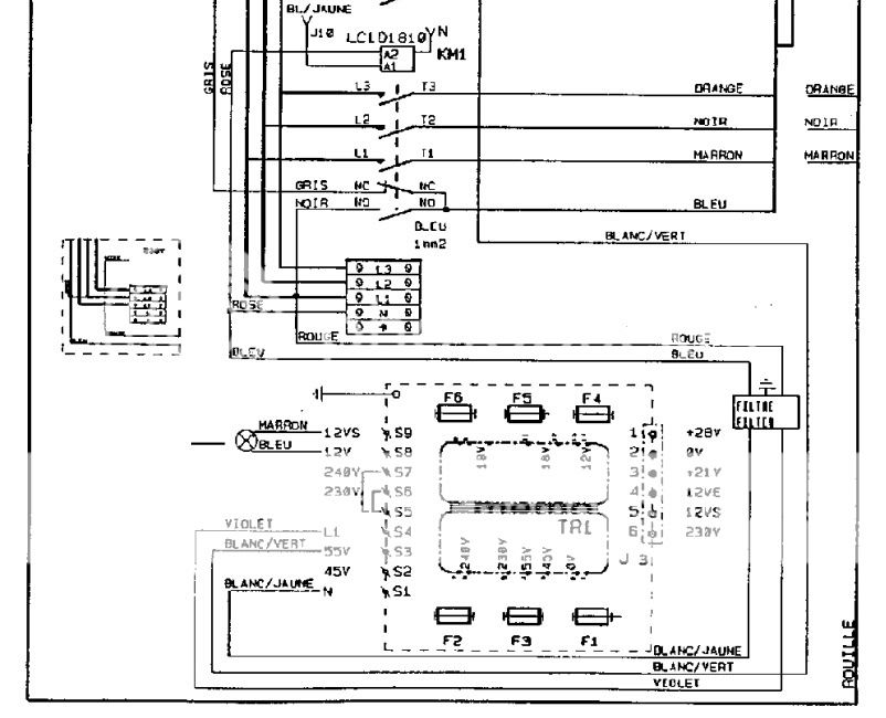

circuit diagram is attached on link
power supply puts out 12 V , 20 volts and 24 volts according to the label , or 12V , 21 volts and 28 volts according to the circuit diagram

I do not recommend trying to just change this IC. This IC is likely a switching supply regulator that died when something else failed. The typical root source failure is an electrolytic capacitor somewhere in the appliance. Tracking down all of the dead individual components is likely more effort than it is worth, despite the high price for the replacement. I agree that $1200US is a lot of money for a 60W power supply, even one sitting in an appliance that makes a lot of heat. So I suspect that this board does something additional to converting moderately regulated AC power to three regulated DC voltages.
If I was trying to cheaply repair this, I would consider an external power supply and cutting out just the power supply part of this circuit board instead of trying to repair the internal supply itself. Don't forget that this circuit board is conformal coated for a good reason. So any rework on this board must be resealed.
Don't forget though, any rework of this board may become a futile exercise because other parts of this oven may also be dead.

yes there was a failed electrolytic cap which i can replace
the cost of an IC and capacitor is likely to be about $ 5
add 2 - 3 hours labour its still way ahead of $ 1200
and yes i am looking for loan benchtop power supply from a friend to use for testing purposes so i can power up the computer inside this thing and test all other functions using the three different voltages required.

The only part that your descriptions could make (some) sense with, would be a powerdip version of L4962 (if you miss-read some markings). But the whole board is a mess and substituting just one component won't make it work. Anyway, $1200 for a plain switching supply is sadly a not uncommon disgrace, and I would also go for a ~$15 full rebuild. And do find what that black sludge is made of and how it found its way in the board compartment, as this probably is the failure reason. S.M.

the black sludge is airborne grease which has solidified on the board ( even though it may look like heat damage its not )
i suspect it has formed there because some idiot fitted an external cover plate upside down , resulting in a cooling fan being obstructed and failing to suck greasy air out of the electrical compartment.
with no cooling fan doing its job the temperature inside this cavity would have risen , creating the conditions for component failure

There's your root cause, the lack of ventilation accelerated the chemical degradation process of the electrolytic capacitors. So to make any repair of this oven not turn into the futile exercise that kramarat implied, I would replace every electrolytic capacitor in this oven. You might have just a few days of operation time left on the remaining components if you don't replace them, too. The man hours quickly climb when a thermal failure happens.

Okay i checked and the component is definitely marked "_ _" 4862A not 4962
It is also marked with ST but they have no reference for L4862A or 4862A on their website

A long shot but when long shots hit they are just as deadly as close range. Try replacing the missing letters or numbers (probably letters) with***, Sometimes the computers will pick up on this and give a list of components containing the numbers you can read. By going through the data sheets you may be able to identify your component. 30 years of faded, burnt, sloppy printing has taught me a lot about how to find 'hen's teeth'. I would agree with you in trying to find the component rather than pay $1200.00 for a new one. Technicians FIX circuits boards, tinkers with lots of money are screw monkeys. Remove the screws and replace the board, anyone can do that!

thats the best i can do with my current camera , looks like a " W " at the start of what ends with _ _ _ 9918
bottom line would be " Malaysia "
does that help ?
there is a transformer soldered to the back of the PCB and i wont be able to remove it to get you the photos of the copper tracks
( not for a few days anyway due to some urgent client obligations )
the other hope is if i could find someone with a Hobart CDS 1012E Combi oven they could just look inside and tell me the full part number of their undamaged item.

Ok, this looks to me like a L4962A. Judging by your output voltages (5V, 12V, & 24V) it makes perfect sense.
The bottom numbers are manufacturers batch and date numbers.
You can buy it here http://www.alliedelec.com/search/productdetail.aspx?SKU=70013662 for $4.40. Be very carefull when you take the old one out as the board and tracks will be brittle where the heat was, I would suggest using solder wick or a de-soldering gun. Hope this helps.

P.S. I would suggest cleaning the board with the following chemical by using a coarse hair paintbrush, looks like there is soot or something on the board, this could have caused the problem to begin with. I had my fair share of shorted relay and contactor coils when I used to repair industrial kilns for smoking salmon due to soot. Nasty stuff! Here is the link: http://www.alliedelec.com/search/productdetail.aspx?SKU=70159740

You got more than just a fried IC the PCB looks to be blown to me, you'v got the relevent part no's for the board, you should be able to get a new unit.
