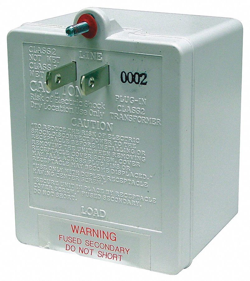

Need to Build this - 12vdc 700amps IN - 16.5vac .5 amps OUT
I have the "IN"
I hope this clears this up.
I can't seem to find any commercial product available and need a little help.
Some sort of schematic I could tweak or someone with a better understanding of inverters.
I do have a definate use for this and do not want to convert 12vdc to 110vac then back to 16.5vac.
Thank you for any input.

See this ? The board I have, can be run with this type of
plug-in transformer. This plug has 120vac in and 16.5vac out. I want to do the same thing only starting with 12vdc. the output has to be pretty close to the same when developed by by the input of 12vdc. But I only need .5 to 1 AMP
Do you know if there are any schematics? That page does not exist you mentioned.

Re: 12vdc 700a IN 16.5vac .5 a OUT Need To Build
08/01/2012 9:14 PM
You understand quite well . 60 hz
Plug-In Transformer 16.5VAC/40VA, 120VAC
Input Voltage
120VAC
Voltage Output
16.5VAC
Output Current (Amps)
40VA
Input Frequency (Hz)
60
Have any Ideas?

If this is to power some widget board, the first thing I would do is check out the power input on your board. It may be the first thing the 16.5VAC goes through is a full-wave rectifier, converting the AC to full-wave DC. If that is the case, you would be able to bypass any conversion to AC, which greatly simplifies your task. If this is the case, post the details, and we can come up with a simpler solution to your problem.
Tom D.
Location: Hells Kitchen , "Yuma, Arizona"
Posts: 10
08/02/2012 8:21 PM
Thank you for the thought .
It does rectify to 12vdc, but "senses" the AC input and reports trouble when no ac is present. So unless I can get the processor code re-written. I need AC on the input. The board works perfect, with 12vdc tapped in after the on board power supply. ( while reporting "trouble")
I do not want to convert 12vdc to 110vac and plug in 110vac transformer that has an output of 16.5vac because of all the power used during the conversion. The current commercial products are geared for higher amperage out ( ie-power loss for such a low power need, as I have) The conservation of power is quite critical.
Thank you again!
I have exhausted all the simple solutions I could think of.
These postings of asking for help are new to me. I haven't designed many things latley and was hoping technology had already exceeded the resolution to any thought I might have.

What is the on board power supply? Bridge rectifier and a filter?
If so then 12VDC will go straight through it with possibly tolerable voltage drop through the diodes.
Have you tried that yet?
How is the AC sensed?
