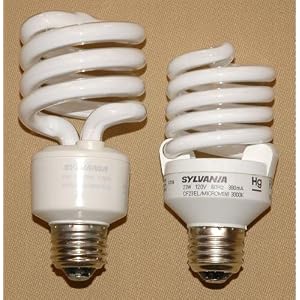

I have a desk fluorescent lamp,12w,I feel it is too glaring at night when i read,so I want to add a dimmer so that i can adjust the illumination,is it possible? and how to achieve it ? thanks..

I think adding dimmer to fluorescent lamps is not possible ,unless you purchase special lamp.However incandscent lamp can be provided dimmer.You need have to purchase saperate dimmer ,simply purchase 100 Wt fan regulator and that will serve your purpose.

You can buy dimmers for lamps like that, but they probably won't provide the dimming range you need. Realistically you need a 200:1 dimming ratio from bright to dim for night use. Dimmers like this will probably only provide 10:1:

If you buy the first one make sure you use it with a dimmable CFL (at more than twice the $) as it says, most CFL's aren't dimmable. I am sure you will be disappointed with the results however, they dim a little and then go out. LED's would be much better at dimming and of course so would an incandescent. I like the suggestion of the two polarized sheets.

You need a dimmable CFL to use with a dimmer. Putting a non dimmable one wil smoke(literally!) both the dimmer and the bulb. I know this from experience. You could just wrap some aluminum foil around part of the bulb, although it might get a bit hot.

yes you can. most fluorescent units cannot work with dimmers, so you may need to replace the units with fluorescents that can work with dimmers.
