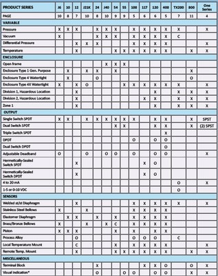

from where I can download the complete catalogue for process measurement switch and process measurement transmitters?
I need to install a pressure switch for the paint line what type I should choose. max pressure 7 kg. temp 60 c

Re: pressure switch selection
04/14/2013 9:51 AM
I use United Electric's now out-of-date catalog because it's comprehensive and it includes a selection guide.
The selection guide portion of the full catalog has been extracted and posted here:
http://www.scribd.com/doc/135838859/Selecting-a-pressure-switch-United-Electric-pdf
United Electric offers a downloadable short form catalog, but it lacks the selection guide:
https://www.ueonline.com/ue-catalog/
In summary, one selects a pressure switch based on:
1) environment - general purpose/hazardous area/weather-tight
2) process variable - vacuum, gauge pressure or differential pressure
3) sensor element suitable for pressure, temperature and exposure to medium
- many process switches are mounted on remote diaphragm seals to isolate the switch from the medium or the environment (heat)
4) electrical switch characteristics - load, number of switches, deadband. SetPoint indicator
5) options, like whether you pay the factory to set the setpoint.
Either catalog or selection guide has a matrix like this:
