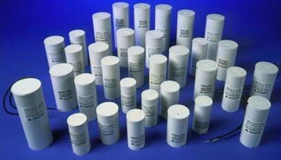

Previous in Forum: Which Would be Better, 12V UPS or 24V UPS?   Next in Forum: Two Wattmeter Method
60 comments
Location: Cajun Country , USA
Posts: 1498
Why Did This Outlet Still Have Power?
05/18/2013 7:40 PM
I just did a Mother-in-law job.
The switch for her outside spot lights was broken and would NOT fully switch OFF.
I killed the MAIN Power on the outside utility box. I know well where and what it is and everything in that little house goes dead when you pull that lever down.
I went in and started unscrewing the Hot and Neutral wires to install a new switch and when the loose wires hit one another ( in my hand) ZAP!!! I got hit with a sudden jolt of juice.
I checked everything with a meter and everything was DEAD. Nothing. I even 'fanned' the wires with my hand and nothing.
WHERE DID THAT SURGE COME FROM???? IT WAS LIKE A SINGLE DISCHARGE FROM A CAPACITOR....BUT THERE IS NO CAPACITOR THAT I CAN TELL BETWEEN THE SWITCH AND THE OUTSIDE LIGHT FIXTURE.
*The light fixture does have a Light sensor for day and night use*
Really curious about this now.
Any ideas?
Re: Why did this outlet STILL have power?
05/18/2013 7:45 PM
You ruled out a capacitor, but did you rule out a transformer?
Location: Cajun Country , USA
Posts: 1498
Re: Why did this outlet STILL have power?
05/18/2013 7:50 PM
I have no idea where to even look for a transformer. The power comes into her ulitilty room from the attic. There is a Blk. Wht. and ground on one sideof the switch and single black on the opposite side.
? ? ? ? Transformer ? ? ? ? ?. . . . on the light fixture outside ? ? ? the Light sensor ? ? ? ?
Re: Why did this outlet STILL have power?
05/19/2013 11:39 PM
A transformer can only return stored energy for a very short time, unless there is something I don't understand...
The time required to take the cover off the switch is far more than the time a transformer could store energy.
It sounds like there is a photo sensor, or possibly a motion sensor. The photo/motion sensor will require a low voltage power supply of some kind, which is almost certain to contain a capacitor...
Re: Why did this outlet STILL have power?
05/18/2013 8:02 PM
Always wear gloves when handling any electrical wiring.
Did you hook everything back up and did you turn the power back on and try to duplicate the arc under more stable conditions?
Is there any other power source that could "back-feed" into the system?
The, "would NOT fully switch OFF" statement indicates a big problem. It should be on, or off. if wired properly.
What did you mean?
Location: Cajun Country , USA
Posts: 1498
Re: Why did this outlet STILL have power?
05/18/2013 10:08 PM
The swithc was probably 20 years old or older. It simply would NOT go all the way into the OFF position.
Re: Why did this outlet STILL have power?
05/18/2013 9:01 PM
There may not have been a capacitor between the switch and the lamp but I bet there is one in the lamp as part of a capacitive coupled power supply for the low power sensor circuit.
Location: Cajun Country , USA
Posts: 1498
Re: Why did this outlet STILL have power?
05/18/2013 10:09 PM
You mean the light fixture may have a small capacitor inside the fixture?
Join Date: Jun 2008
Location: Raleigh, NC USA
Posts: 13529
Re: Why did this outlet STILL have power?
05/18/2013 11:32 PM
That's it. GA.
Location: Cajun Country , USA
Posts: 1498
Re: Why did this outlet STILL have power?
05/18/2013 10:14 PM
It looks just like this.
One single No. 14 x 3 wire coming out of the attic into the wall.
A Blk. a Ground and A Neutral on one side, a single Blk. on the other side.
Wiring goes out to the fixture....just like the one shown here.
Good Answers: 445
Re: Why did this outlet STILL have power?
05/19/2013 6:29 PM
That looks like an older fixture with a CdS (cadmium sulphide) photodetector. Usually the circuitry in those included a capacitor to provide a time lag so that the light didn't trigger from a passing car's headlights.
Nothing is ever dead until the leads are shorted together and a voltmeter verifies it.
Location: Cajun Country , USA
Posts: 1498
Re: Why did this outlet STILL have power?
05/19/2013 10:06 PM
Lesson learned! I would have never guessed something like that.
The wholelight fixture is dead tonight.
Switch is rewired and OK, but the spot lights are not operating. The fixture is old. Probably shorted something inside.
Location: Surrey BC Canada
Posts: 1571
Good Answers: 42
Re: Why did this outlet STILL have power?
05/19/2013 10:45 PM
That sounds like the light is fed from somewhere else and that spark you got opened the fuse / breaker.
Now you just have to find out where the power comes from!
Location: Cajun Country , USA
Posts: 1498
Re: Why did this outlet STILL have power?
05/20/2013 9:04 AM
I can only guess. This house was built in the 1940's and has been rewired by who knows how many people.All is well.As for now the outlet with switch is OK. Light outside is not. I will take off the old fixture and get back to the single romex x 3 strand that i see coming out from the attic. I should have power there. ...I know I have Yellow Jackets!
Join Date: May 2010
Posts: 1281
Good Answers: 27
Re: Why did this outlet STILL have power?
05/20/2013 8:06 AM
Personal Safety First!
Now that you are not sure where the original power came from, and rather chase your tails trying to find out where that power that initially shocked you also came from, it would be a lot easier /simpler for you to run a new set of 3 wires (BX /Romex) type. Connect the new wires back to the main breaker box that you know where power should be coming from... But be sure that the mains is really OFF before touching anything!
Since there is no longer power coming from the unknown old wires, (since lamp still didn't work after switch replacement), the old wires can either be pulled out completely, capped or shorted together for safety...
vsar
Posts: 1469
Re: Why did this outlet STILL have power?
05/20/2013 10:39 AM
All circuits need a return, but you describe a single black coming out of the switch. My guess is therefore that the return circuit comes out of the back of the fitting and finds a different way back to the distribution board (against the UK wiring code for this very reason). Somewhere along that way it has been commoned with the return from another fitment which was live at the time. The fuse protecting that second fitment has now blown.
As for capacitors in power supplies, these are not present in the input of either transformer or switched mode power supplies. The capacitors used to stabilise the DC output cannot drain back to the input.
Location: Cajun Country , USA
Posts: 1498
Re: Why did this outlet STILL have power?
05/20/2013 12:01 PM
I am not fully understanding your description of what happened. However, this house has circuit breakers, no old type fuses.
After I reinstalled a brand new switch, the swithc has power but the light does not work. I HAVE NOT un-done the circuit box and removed the old light fixture as yet.
I will test the wires when i do ( after i kill them dang yellow jacekts!).
If something is still amiss, I'll call in someone qualified.
Thank you for the comment.
Re: Why did this outlet STILL have power?
05/20/2013 2:26 PM
There are a lot of low power devices that do not use SMPS or transformers when line power isolation is not necessary.
Here is a basic schematic of a capacitive coupled power supply which is very common on things like outdoor lighting control circuits and other line powered devices that have very low power requirements.
If the manufacture went with a high value resistor across C1 the self discharge time could be on the order of 10+ minutes or if they were really cheap, which I have seen many times, they may have went with a design similar to what this schematic shows and had no self discharge resistors at all.
So yes the dusk to dawn circuit in the OP's outdoor light could very well have had a small capacitor in it that could have stored enough charge to produce one good POP when shorted out! A .5 uF or more low ESR capacitor charged to 160+ peak volts, like any common 120 VAC power line carries, can easily make one good and surprising spark!
If the OP's in part of the world that uses a nominal 220 - 240 VAC the peak voltage could be up around 300 - 350+ volts allowing for an even smaller capacitance to still give a good hot and surprising spark.
Re: Why did this outlet STILL have power?
05/18/2013 10:15 PM
High pressure sodium outdoor lights have capacitors....
Metal halide lights have capacitors....
Mercury vapor and low pressure sodium lights can have capacitors.....
Location: Cajun Country , USA
Posts: 1498
Re: Why did this outlet STILL have power?
05/18/2013 10:17 PM
Nothing that big.
Re: Why did this outlet STILL have power?
05/18/2013 10:15 PM
Have you replaced the switch, and is everything OK?
I'd not worry is this is the case.
Location: Cajun Country , USA
Posts: 1498
Re: Why did this outlet STILL have power?
05/18/2013 10:17 PM
Nope, not at night I'll do it tomorrow while she is at church and I can kill everything again.
Join Date: Sep 2007
Location: Japan
Posts: 2703
Good Answers: 38
Re: Why did this outlet STILL have power?
05/19/2013 9:03 PM
You are talking about the power right?
Location: Cajun Country , USA
Posts: 1498
Re: Why did this outlet STILL have power?
05/19/2013 10:09 PM
Ha ha Ha! Yep. Just power. Mother in law has treated me the best for the 38 years I've known her. She is a saint.
Location: Cajun Country , USA
Posts: 1498
Re: Why Did This Outlet Still Have Power?
05/19/2013 10:03 PM
Replaced the switch today.Power to the Switch, nothing at the light fixture. I taped the photo cell black and no light.. . . as of tonight, still no light.
I'll pull of the fixture next week end and replace all. I hope I have power inside the junction box . I really do not want to start pulling wire inside that low little attic.
As a side note;
* broke a shock on my truck going into town for parts......hit a leaf covered pot hole you could have hidden an Abrams in.
** Got the $h!t stung out of me by a nest of yellow jackets hidden just under the eave by the light fixture
I can't wait for Monday to start! Its got ot be better then thuis week end!
Join Date: Nov 2010
Posts: 277
Re: Why Did This Outlet Still Have Power?
05/19/2013 10:32 PM
In such cases, where we are unsure whether there is a capacitor in the system or so, how do we "kill the power" completely or be sure there is no stored charge in transformers or capacitors waiting to hit you?
I understand the precaution of working with gloves and everything, but apart that?
Location: Surrey BC Canada
Posts: 1571
Good Answers: 42
Re: Why Did This Outlet Still Have Power?
05/19/2013 10:52 PM
The light he has looks like a standard incadescent type. The photocells on my lights have no capacitor, they are thermal bymetalic strips and the thermal time causes a delay. Transformers discharge their energy in milliseconds. By the time he has killed the main power any capacitor should be discharged within about 5 seconds (code requirements).
I still think the power is coming from somewhere else that we don't know about-
(Power saver - it is on the line side of the meter?)
Join Date: Feb 2009
Location: West Coxsackie, NY
Posts: 533
Re: Why Did This Outlet Still Have Power?
05/20/2013 12:36 AM
Is there a capacitor on the HVAC fan?
"Real Bass Players" do not use picks
Location: Cajun Country , USA
Posts: 1498
Re: Why Did This Outlet Still Have Power?
05/20/2013 8:58 AM
do not know.
Posts: 1217
Re: Why Did This Outlet Still Have Power?
05/20/2013 1:10 AM
Go see a shaman and get smudged, you got some bad juju workin' on this one!
Location: Cajun Country , USA
Posts: 1498
Re: Why Did This Outlet Still Have Power?
05/20/2013 9:00 AM
...got a Cajun Treateur that already threw some Gris Gris powder and salt at it. Must be something buried on the property maybe????
Posts: 1217
Re: Why Did This Outlet Still Have Power?
05/20/2013 9:12 AM
Who knows. But with a string of luck that bad, you don't need to be a believer to do a little juju fix! Can't hurt. Besides, It might help you feel clear and think better to get it fixed.
Popular Science - Weaponology - New Member Canada - Member -
Location: In the sticks of the Central Kootenays, BC, Canada
Posts: 266
Re: Why Did This Outlet Still Have Power?
05/20/2013 1:13 AM
You say you were handling the hot and neutral wires...if they were the power feed TO the switch (from the house distribution system) you may have seen the action of a capacitor elsewhere in the system. Maybe a fridge or a deep freeze was on? Maybe there is a well pump or some other device that has a decent size capacitor that could potentially backfeed to the hot wire.
As others have suggested, capacitors are "supposed" to have resistors across them to discharge them within 5 seconds; this could be not necessarily true in an old house.
You might not even see this residual charge with an electronic multimeter. I found I could not read the voltage on a capacitor long ago with a cheapo Radio Shack digital multimeter and could only detect it with an analog meter because the meter would kick when connected to the capacitor, at the same time it was discharging the capacitor.
If you were being back-fed from another power source you would see the continuous power with a meter. It wouldn't go away by testing it, unless, of course, you blew a breaker or fuse somewhere when the spark happened. But a motor starting capacitor can make a heck of a spark...we used to waste time at the university dorm by charging them up in an electrical outlet and zapping each other...sometimes many minutes after charging it. Another point--you may not see this phenomenon the next time you throw the breaker because the capacitor charge depends on the exact point in the AC waveform you actually break the power.
What you probably should do is verify there is no power on the wires in question and then short them before working on them.
Hope this helps. Stay safe!
Jon.
Location: Cajun Country , USA
Posts: 1498
Re: Why Did This Outlet Still Have Power?
05/20/2013 9:08 AM
Yes, there is an AC, a refrigerator and a well pump on this property.
Location: Cajun Country , USA
Posts: 1498
Re: Why Did This Outlet Still Have Power?
05/20/2013 11:25 AM
... I sold some sampling nets to a Biololgist working on the Kootenay River.
The pictures he sent back of the locale were absolutely beautiful. Really a big change from this humid @$$ swamp we live in called Louisiana. ha ha!
Popular Science - Weaponology - New Member Canada - Member -
Location: In the sticks of the Central Kootenays, BC, Canada
Posts: 266
Re: Why Did This Outlet Still Have Power?
05/20/2013 12:50 PM
Yeah, you are right. I've spent 25 years of my life not far from the Kootenay River. Nice country-the bugs aren't as big as dinner plates and we can go out in the bush without fearing snakes that can kill you. The downside is that there is still snow in the bush right now and it starts to snow again only a few months down the road.
J.
Join Date: Nov 2010
Posts: 277
Re: Why Did This Outlet Still Have Power?
05/26/2013 5:12 AM
So are you saying that before touching the hot wires in such a case, we should short the neutral and hot for a few seconds or so before proceeding to work on them?
Join Date: Sep 2007
Location: Japan
Posts: 2703
Good Answers: 38
Re: Why Did This Outlet Still Have Power?
05/26/2013 8:55 PM
When not having a measurement device, these are handy, but must be used correctly.
Popular Science - Weaponology - New Member Canada - Member -
Location: In the sticks of the Central Kootenays, BC, Canada
Posts: 266
Re: Why Did This Outlet Still Have Power?
05/27/2013 1:44 AM
Yes, but verify that there is no power via a multimeter first. This is because most modern meters are very high impedance and would not necessarily discharge an upstream capacitor. Touching the wires together will discharge any capacitors waiting on line to bite you.
Note that I am making a distinction between power as one would see on a live line as supplied by the electricity utility and the presence of a charged capacitor on the line. There is really no difference but the operation of a meter when checking for charge from a capacitor may not be reliable, as I pointed out in my first post. However, you can place high reliance in a meter to detect the presence of utility power.
If you have a high quality meter that you know responds reliably and detectably to capacitor charge then these comments can be pretty much ignored. You will know there is some voltage on line and can then take steps to deal with it.
But, without that expensive meter, momentarily touching wires proven to have no utility power to them will guarantee that any capacitors on the line are discharged.
Jon.
Join Date: Oct 2012
Location: Located in South eastern North Carolina, I am a retired Supt of Public Works. also I am wheelchair confined due to an INdustrial accident of the Bends (Caissone Disease) from a construction Diver/underwater mechanic.
Posts: 64
Re: Why Did This Outlet Still Have Power?
05/20/2013 8:21 AM
I would look for an inconsistant surge coming in on the neutral ground. This is especially true when you are located in a rural situation.
I know I will get Poo Pooed or laughed at, but I milked cows in a very rural area, in the Northeast US the neutral carried 45volts "inconsistantly" on the neutral off the public power supply.
The cows were/are extremely sensitive to low power surges of this sort because they are well grounded, especially on a wet concrete floor. This stray voltage cost me many thousands of dollars, due to cows reluctance to produce milk in a milking parlor under these conditions. Multiple grounding rods are required to circumvent this problem. A stray voltage monitor is required to detect this sort of power source.
Location: Cajun Country , USA
Posts: 1498
Re: Why Did This Outlet Still Have Power?
05/20/2013 9:11 AM
Understood. There are a few items like the fridge, AC and well pump hooked into the house's utility box outside...... Any of them could be the culprit.
Join Date: Feb 2010
Posts: 268
Re: Why Did This Outlet Still Have Power?
05/20/2013 10:05 AM
static electricity, you are wearing a nylon and cotton and touch the wires and gott sappet with a static current, and in the dark and working on the power outlet you thought in your mind that you did got it from the grid somehow. atliest my theory...
guds777
Location: Cajun Country , USA
Posts: 1498
Re: Why Did This Outlet Still Have Power?
05/20/2013 10:17 AM
You could be right, but I've never seen a static discharge that blue, smell of ozone and burn like that did.
Posts: 136
Re: Why Did This Outlet Still Have Power?
05/20/2013 11:32 AM
it could be that someone tied into the power Before the meter and hid the connection.Disconnect the light and check and see if you have power when you turn on the mains, Also should be FIRST check for power before you turn on the mains.Next if it is tied in before the mains someone could have put a fuse in between the light and the main connection.and it blew.and that could be why you dont have power if you turn on the mains. Go and buy yourself a Meter also.
Location: Cajun Country , USA
Posts: 1498
Re: Why Did This Outlet Still Have Power?
05/20/2013 11:50 AM
Thank you for the heads up.
I will untie everything next week end when I return for the 'rest of the list' of to-do's at Mom -in-law's house.
I have two meters ( probe type) They did not register anything .
Is there something more accurate and reliable for house-hold current jobs like this?
Re: Why Did This Outlet Still Have Power?
05/20/2013 1:57 PM
If you don't already have one, get a Fluke VoltAlert or one of the several other brand similar devices. I never work on power circuits without first checking. These devices detect the presence of potential, whether there is any current or not. You simply hold the tip of the device near (does NOT need to touch) a wire, and if the wire carries a voltage, it will flash and/or beep. They are available for various voltage ranges. They are cheap ($15-25) and reliable, although you should always check on a known live wire every time you use it to indicate the absence of voltage. I have a Greenlee GT16 that is rated for 5-1000 VAC; one problem with it is that even though it has a sensitivity control, I can't get the sensitivity low enough to be sure which is the neutral or hot within a single cable unless the wires are separated. With the Fluke, I can. In fact if you run the Fluke along a standard twisted power cord, you can tell how tightly the wires are twisted, as the light will come on each time the hot wire is on the side of the cord nearest the sensor, and go out for the neutral and ground wires.
On the other hand, if your spark was caused by energy stored in a capacitor, that would be DC, and I'm not sure just how any of these devices respond to DC...
Join Date: Nov 2012
Posts: 633
Re: Why Did This Outlet Still Have Power?
05/20/2013 3:06 PM
Shop secondhand/pawns for a 'wiggie'...i.e. a Wigginton volt tester...it's a solenoid type tester for ac/dc, the solenoid pulls against a spring and a scale pointer on the side indicates the voltage, a flip magnet on the top indicates polarity. Good to 600v ac or dc. Used to be in every electricians bag until modern 'digital' meters. Not much use under 80 volts.
Join Date: Jan 2010
Location: Dayton Ohio
Posts: 266
Re: Why Did This Outlet Still Have Power?
05/20/2013 1:15 PM
Bees, wasps, and hornets won't fly after dark or when it gets cold.
It sounds like you may be dealing with a "hallway" circuit with that second black wire, and need to use a 3-way switch. Is there a second switch that operates that light?
MikeMack747
Location: Cajun Country , USA
Posts: 1498
Re: Why Did This Outlet Still Have Power?
05/20/2013 2:46 PM
The Romex 3 strand comes out of the attic into a switch circuit. It is connected with BLK. WHT and ground on one side and s single black on the other.
Until I take off the fixture outside, i will not know.
I am waiting for supply delivery so I have some slack time. I just might head over there in a little while and pull the thing off the eave and see what's what.
Join Date: Aug 2009
Location: Glen Mills, PA.
Posts: 2385
Good Answers: 114
Re: Why Did This Outlet Still Have Power?
05/20/2013 6:58 PM
The flash came from your personal magnetism mate,not the electric.
Location: Cajun Country , USA
Posts: 1498
Re: Why Did This Outlet Still Have Power?
05/20/2013 10:41 PM
HA!HA!HA!
Re: Why Did This Outlet Still Have Power?
05/20/2013 10:30 PM
It sounds like you are already in the habit of working one handed, but if that isn't the case, it is a good time to take up the habit.... Just put your other hand behind your back.
Getting shocked still won't be pleasant, but it is far less dangerous if it doesn't cross your heart.
Also, it is a good idea to 'tag out' any breakers your open, in case someone comes home or forgets and decides they should fix the power outage. Something as simple as masking tape over the opened breakers could work.
I realize that is probably not what happened in this case, just a friendly reminder.
Location: Cajun Country , USA
Posts: 1498
Re: Why Did This Outlet Still Have Power?
05/20/2013 11:00 PM
Well, I just came back frmo Mother-in-law's house.
I traced all the wires and found no issues.
Straight forward , a light fixture feeding off of a light switch receptacle.
However, when I went to put the power back on, one room stayed dark. I went back over the breakers and turned each one off and on again.... it seems there was one breaker that is weak. . It did not spring back as hard as the other ones did. It is warm to the touch but not overly hot. I do not know if this contributed to the flash, but its good to know so i can change it out anyway.
You know what the absolute funniest thing about this situation is? Mother-in-law has 2 electrician grandkids (one certified to work off shore) , one certified for air conditioning and a third who is a Electrical Engineer. All 3 live within 5 miles of her house. Still she insisted on having me come look at it. Go figure.
Thank everyone for the input. As usual, I learned a lot . I always do on this forum. Its simply the best place to go any kind of advice. thank you all again.
*Saia freight is delivering supplies tomorrow... I am sooo glad to get back in that hot @$$ shop and sew some nets..... Thank Everyone again.
Good Answers: 109
Re: Why Did This Outlet Still Have Power?
05/21/2013 1:56 AM
CR4 trained - beats even the best schools!
Posts: 668
Good Answers: 15
Re: Why Did This Outlet Still Have Power?
05/21/2013 5:14 AM
Since everything else has been covered. And it hasn't happened again.
Could it have been a static discharge?
scotchdrnkr
Location: Cajun Country , USA
Posts: 1498
Re: Why Did This Outlet Still Have Power?
05/21/2013 8:17 AM
Always a possibiliy I suppose. Hopefully I will not have to find out again and all is good for now.
Location: Virginia, USA
Posts: 227
Re: Why Did This Outlet Still Have Power?
05/21/2013 6:26 PM
It's not too unusual in older houses to find "undocumented" circuits. If there is one and the house still has switches on the return (white) rather than the power leg, it WILL give you leakage into the house wiring, leading to your situation. I had an early (1883) row house in NJ at one time and until I switched ALL of the switches to the power (black) wire, I had 60V AC in every metal switch plate. It was reverse feeding through the incandescent filaments. Prior to my rewiring, the house had a mix of switched legs and this caused the problem. I can only eonder just how much power was wasted (and billed) before that. What alerted me, was the 'tingle' I got every time I touched the switch on the bathroom lights. Since I found the same situation in other houses, I'm assuming that switches on the return were code acceptable at one time.
Robert A. Heinlein (1907-1988) "There is no worse tyranny than to force a man to pay for what he does not want merely because you think it would be good for him."
Location: Cajun Country , USA
Posts: 1498
Re: Why Did This Outlet Still Have Power?
05/21/2013 7:33 PM
Thank you for the reply.
It is another lesson in my CR4 Training course.
Location: Cajun Country , USA
Posts: 1498
Re: Why Did This Outlet Still Have Power?
05/21/2013 7:35 PM
Your signature line is absolutely the most relevant thing i have heard in years... so true today more than ever.
Re: Why Did This Outlet Still Have Power?
05/25/2013 12:17 PM
you have more confidence that your Main was fully in the "off" position than I am, I'd be checking that long before searching for capacitors in lamps and transformers. just because you hear it click doesn't insure its been fully opened and no current path exists. something as small as a crushed bug in the contact area can provide an adequate path for enough current to floor you. It might not be enough for your lighting system but its enough to cause harm.
Location: Cajun Country , USA
Posts: 1498
Re: Why Did This Outlet Still Have Power?
05/25/2013 1:43 PM
You are 110% correct. i was not being as cautious as i should have been.
Register to Reply 60 comments
bluebelly (1); Bob Sullivan (1); conntaxman (1); Deefburger (2); dkwarner (2); Epke (2); Fredski (1); geraldpaxton (1); guds777 (1); GW (2); IdeaSmith (1); Jay_ (2); Jimh77 (1); kramarat (1); lyn (2); MikeMack747 (1); netmaker (25); passingtongreen (1); phph001 (1); RAMConsult (1); sawmilleng (3); scotchdrnkr (1); SolarEagle (1); tcmtech (2); truth is not a compromise (1); Usbport (1); vsar (1)
Previous in Forum: Which Would be Better, 12V UPS or 24V UPS?   Next in Forum: Two Wattmeter Method
