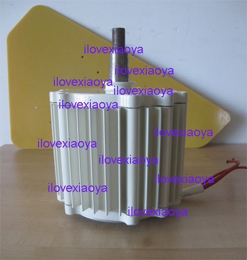

Here guys is a cool picture for you...

Bike, like custom motorbike or bike like custom bicycle with pedals? I am very confused again, since You posted a wheel that looks like fitting a scooter.
As I read here, you will use the B&S to generate power and simultaneously charge your buffer batteries? Or just use it to charge your batteries as that?
Bringing 2 alternators, the B&S on the frame is weight that needs energy also to bring it from A to B.
I have played a bit with "assisted power motors" in the wheel(s) of regular bicycles. Unless you have far bigger types, do not expect too much of the power output.
300 Watts is still no 5 Horsepower (or 3600 Watts). And each conversion also adds up to some losses.
