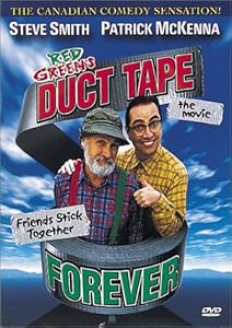

Previous in Forum: CR4 Down for Some Tidying Up.   Next in Forum: Air Compressor
10 comments
Join Date: Mar 2008
Location: NY
Posts: 2313
Good Answers: 59
Duct Tape Festival
06/18/2013 8:53 AM
How did we miss this? The 10th annual Duct Tape Festival was held last week. Did you attend? What's the craziest thing you've made of duct tape?
http://www.ducttapefestival.com/
Pathfinder Tags: duct tape
Posts: 11119
Good Answers: 918
Re: Duct Tape Festival
06/18/2013 9:11 AM
If I brought a big bucket of Goo Gone to the festival would I be a party pooper?
Re: Duct Tape Festival
06/18/2013 6:01 PM
I used duct tape to hold a tarp down on my pickup. Once. I'll ever do that again. I spent a couple hours using Goo Gone to remove the tape residue with not much result. Frustrated, I tried a few other solvents and found that 70 percent isopropyl alcohol does a much better job.
Join Date: Feb 2012
Posts: 595
Re: Duct Tape Festival
06/19/2013 12:41 PM
try coocking oil (1-st) + (then) that alcohol next time (multi-cycle if required)
ci139
Posts: 687
Good Answers: 21
Re: Duct Tape Festival
06/21/2013 11:18 PM
Use the oil to make a blackened steak on the grill and the alcohol to stooth the mind.
Re: Duct Tape Festival
06/18/2013 1:28 PM
This should have been an IHS GlobelSpec sponsered event.
Join Date: Mar 2008
Location: NY
Posts: 2313
Good Answers: 59
Re: Duct Tape Festival
06/18/2013 2:10 PM
Who would the featured speaker have been?
Posts: 5197
Good Answers: 266
Re: Duct Tape Festival
06/18/2013 4:11 PM
Steve Smith
Re: Duct Tape Festival
06/19/2013 8:58 AM
Location: Maine, USA
Posts: 2168
Re: Duct Tape Festival
06/19/2013 7:28 AM
I missed that festival as I was busy repairing the hose on my lawn vacuum with Duct Tape ...I'm planning to visit the Moxie festival on July 14th. if I can! I do have some work clothing that has Duct tape repairs too!
Location: Up North
Posts: 540
Re: Duct Tape Festival
06/20/2013 9:13 AM
I once knew a woman from Minnesota who made a duct tape bikini. Smokin' hot. She looked good in a bacon bikini too. Her beer cap bikini didn't turn out so well.
Register to Reply 10 comments
Anonymous Hero (1); ci139 (1); fixitorelse (1); JPool (1); ozzb (1); rashavarek (1); SavvyExacta (1); Steve of the North (1); Tom_Consulting (1); Usbport (1)
Previous in Forum: CR4 Down for Some Tidying Up.   Next in Forum: Air Compressor
