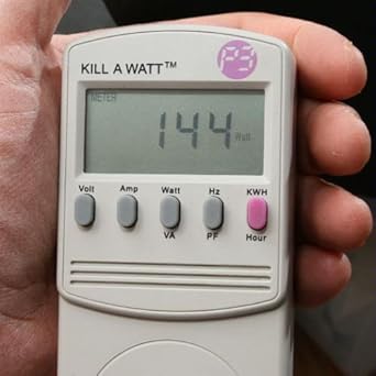

In practice, this is easy. A Kill-a-Watt meter will show either VA or watts, power factor, etc, so getting the imaginary part is a simple matter of subtraction.

Re: Imaginary Current
07/11/2013 1:08 PM
Kill-a-Watt meters are great toys tools.
Seriously, I use mine a lot. (My wife thinks I'm crazy)
