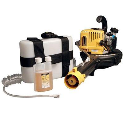

Well I usually fog the place first, early in the AM, just before sunrise.....
http://garden.lovetoknow.com/wiki/Mosquito_Fogger
