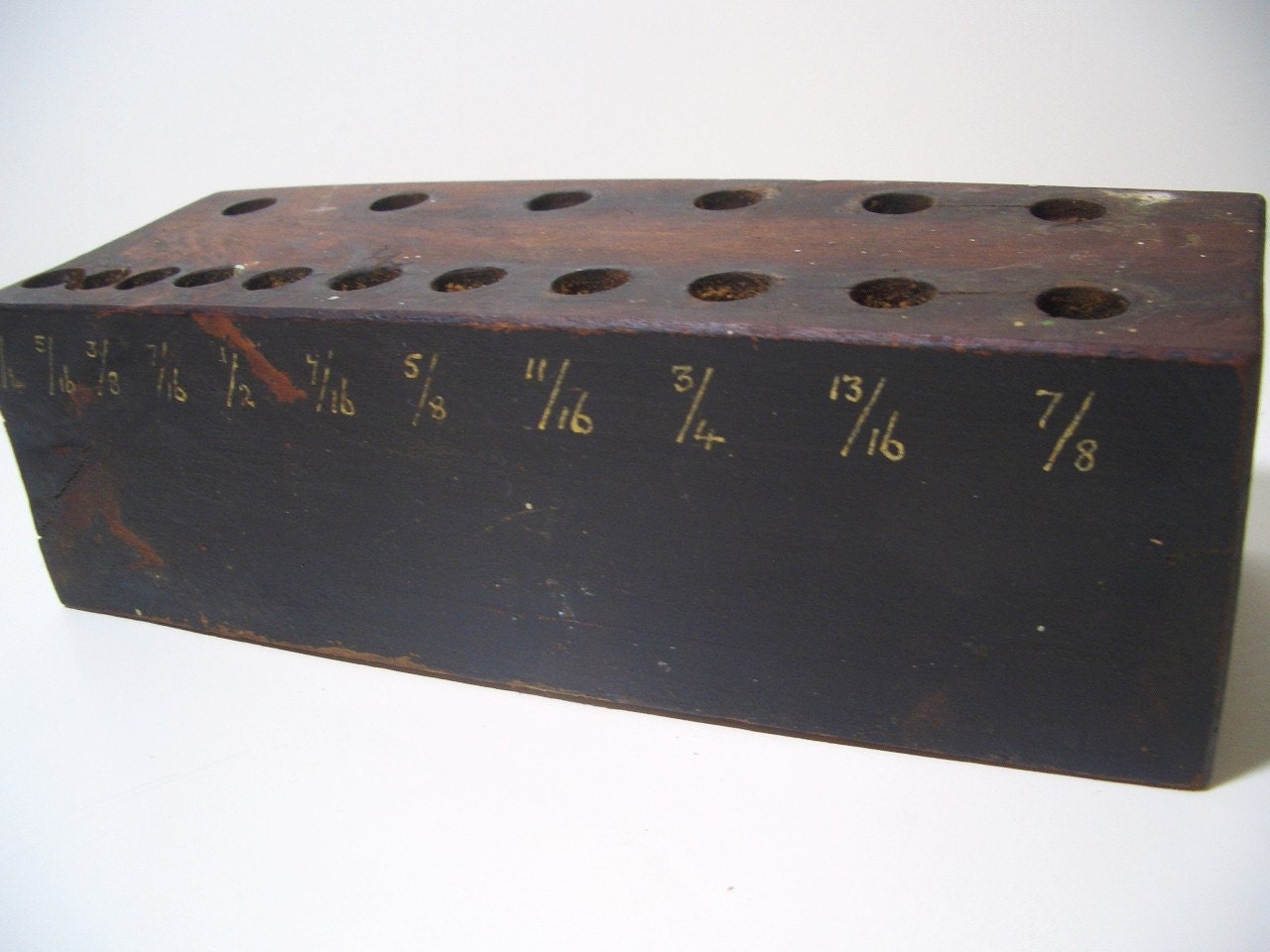

I have about 50 odd size drill bits and taps in metric and imperial and currently I store them in a box which is very inconvenient to find what I want
I would like to store them in a way which I will be able to find what I want easily and one idea I have is to cut a piece of melamine, drill some holes and put them all on top standing up.
That's easy enough but then I have to label each drill / tap what size it is and some taps have their specific drill bit. Labeling looks like to be a problem because it has to be neat and not removable
I wonder if anyone came up with a better idea

Just drill holes in blocks of wood.
That's what machinists have been doing for over a century. It still works.
Otherwise, buy one of those 60-drawer plastic cabinets at Wal-Mart and label the drawers.

What you are looking for is called a "Drill Index" they are usually a small sheet metal box with folding inserts to hold a complete selection of drills in various series. For example fractional inch sizes from 1/16 to 1/2 by 64ths, number sizes, letter sizes, or metric sizes. They are available from any industrial supply outlet.

Since their all odd sizes don't see the problem most likely don't see much use anyway.
Have mine in drilled wood. Didn't mark them. For one size marking can lead to false sense of security. Some of which are so close in size it's better to force yourself to get out the mics or calibers to make sure.

My system is a bit of a hybrid, but very flexible and has easy access.
I have an 18" long x 4" wide x 4" tall box filled with #6 coin envelopes.
All my twist drills are organized by size with the decimal, # size, and fraction information appropriate for that bit written on the bag. This works very well for all sizes up to about 1/2"
In the back, I have a separate section for taps. In each envelope are a variety of taps for the same size thread, and additional twist drills for pre-drilling for the tap (with that size written on the bag as well).
Along the sides of the box, I have some look-up guides, empty envelopes for expansion, and a note card with sizes I need to re-order.
The size of the box was perfect to allow for all the sizes (US), and room for some Metrics, as well. If the box is not full with all your sizes, you can put a block of wood in the back to keep the bags standing up.
In use, I pull the envelope out or just lift the flap for the size I am using, then I know where to return it. The box can move with me to different work stations and be kept out of the way when not in use like any drill index, just a little larger.
This system has the flexibility I need for a growing inventory, including many copies or different finishes of the same size drill in some bags for some of the more popular sizes.
My larger bits, taps & dies I don't use that much, so I keep them in segregated drawers by type in my parts cabinet where I keep counter sinks, Christmas Tree bits, deburring tools, handles, etc..
Hope this helps...

The best drill index is the one that fits your needs!
Being a Machinist for so many years, everyone i worked with had a different way of organizing their drills and taps.
There is no one perfect system.
I, myself had a triple drill index. (Fractional, Number, and Letter) and because I was the only one using it, I could trust the markings and that the drill was the correct size I needed.
All my taps were in my tool chest roughly separated by size or supplied by the shop.
However, almost every Machinist did have a wood block with holes drilled in it for the most common bits.

I use (with satisfaction) the drilled block mentioned by several posters. I placed the most used sizes on top, and the seldom used sizes in the side. Still had them handy, but not crowding the most often used sizes.
In addition, I drilled out a larger hole on one end and inserted a small metal cup to be filled with drill/tap fluid. Handy, works out very well for me.

For my block I took a block of wood and drilled in a pattern of 5 holes deep by whatever is needed wide. All holes are drilled slightly over size for the piece in it. One row of 5 for each size/pitch. First hole in the rows is for the taper tap, 2nd is for plug tap, 3rd for the bottoming tap, 4th for tapping size drill and the 5th for the hole size drill. Holes are spaced wide enough to get my big fingers in to pick up a tap with my thumb and index fingers. A sheet of old rubber gasket material is glued on the bottom to prevent sliding. All rows (5 holes) are labeled as to the size thread and the columns labeled as to type at each end. Made out of mahogany laminated together (because it was available free). Haven't polyurethaned it yet but should have before using it for esthetic reasons. Limited it to up to 1/2" because I seldom use bigger than that. When I make my next one it will be two pieces, one 0--->#5 and 6---> 1/2", the smaller ones are seldom used and can sit in a cabinet until used and then put back in place.
Excess taps are kept in coin envelopes (better than bank money envelopes) in a box in a tool stand.
