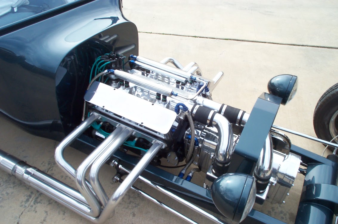

Let me answer some of the questions. The car is my street rod, a '23 T-bucket, built with a remote radiator, electric water pump and electric fan. I experiment with different ways to control coolant temp. Started with simple thermostatic switch, then used a Dakota Digital unit that switches two fans with individual off and on temps. Got the Painless unit now and will install it this winter. I'm wondering what will happen. Will the temp stabilize or will the system always be chasing? We can simplify the analysis by assuming the car is just sitting at idle, removing some variables.
This is a very basic process control loop, without any self-tuning or sophisticated algorithms. Adjusting T1 and T2 is the only "setpoint" control.
The temp sensor is presently in the motor and the fans of course are on the remote radiator. Would it be better to have the sensor at the radiator?

It's a 350 SBC crate motor. The electric water pump was needed because the motor has a Potvin blower which mounts to the front of the motor and there is no place for a mechanical pump, or a thermostat. Here's the setup:
Radiator is in the back, with long hoses in the frame.
The Dakota Digital unit worked fine for temp control, but it was constantly switching the fans off and on. I think the Painless unit, with it's fan speed modulation, should be easier on the fans. But they have lasted for 20 years already, so it's not a big deal apparently.

Yes, car is 20 yrs old and has had many changes. Show it locally in MSP and big events. Took it to CA twice, once for the LA Roadster show. Here's a bunch of pics:
https://plus.google.com/photos/104971212334307682869/albums/5552767776876190417

Wish I had seen that picture before I wasted half an hour on my replies.
