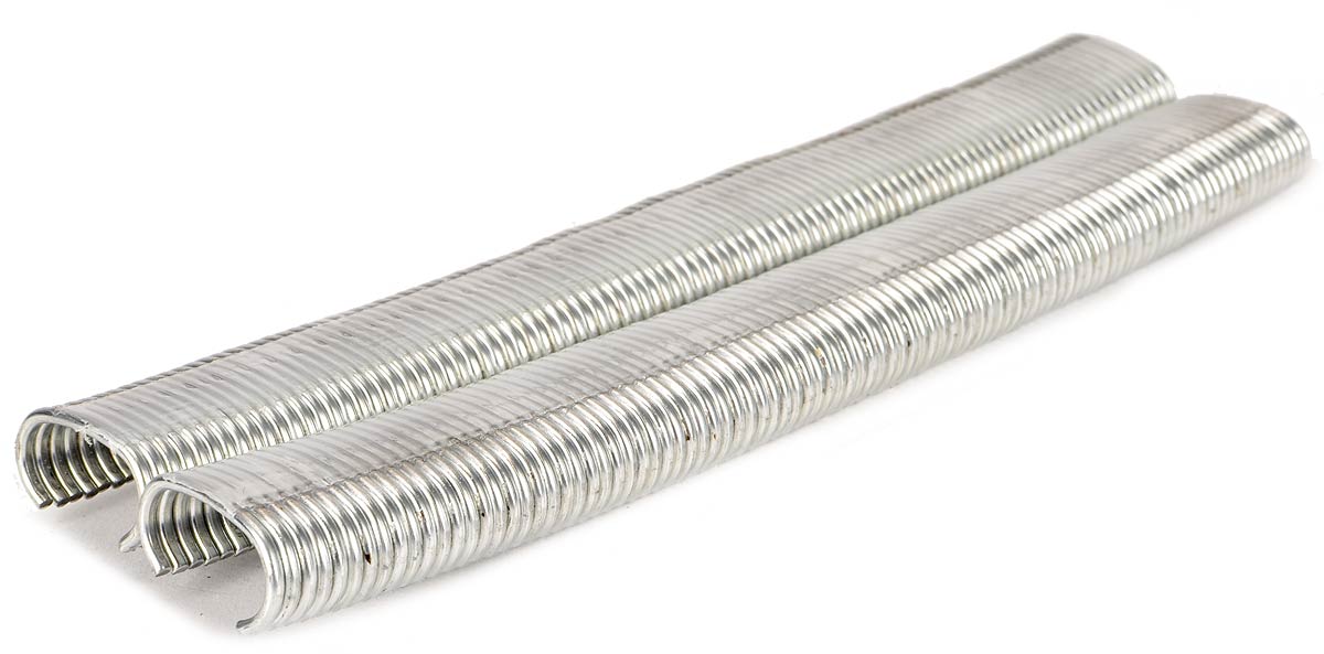

I am looking for a stainless steel crimp or clip or ferrule that has to be open to be able to put it over two .032 pieces of wire mesh to act a a hinge. They have to fit snug. Thank you for any help .

Pound ($7.87)25LB ($167.99)
Stainless steel hog ring. 1-1/4", 14 gauge. Sold by one pound bag or a 25 pound box. Approximately 331 hog rings per

Thank you but .032 wire x2 is pretty small and they don't make hog rings that small

If you don't like shoat rings, how about the 'C' or 'J' clips for assembling wire cages.

Thank you but they are all to big, I have done lots of searching from bunnies to jewelry and lots inbetween . I would want the clips or crimps to be no more than an 1/8 of an inch to 3/16 wide .
