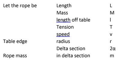

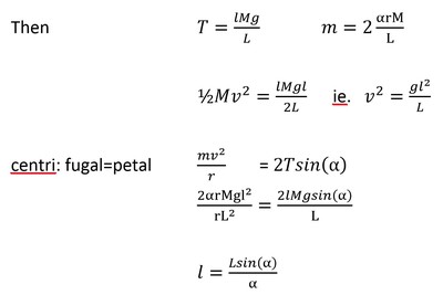

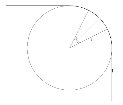

This is a reply to Fyz's supplementary question. When does the rope leave the edge of the table.
I'm struggling a bit here:
Looks to me as though if you consider just a tiny bit of the rope then as alpha tends to zero, l tends to L
Even if you look at the whole edge ie. alpha=45° (π/4) then l = 2√2L/π = 0.9L
This is not what my intuition tells me, and, I don't believe it's the result Fyz has calculated, so, I've clearly made a mistake.
