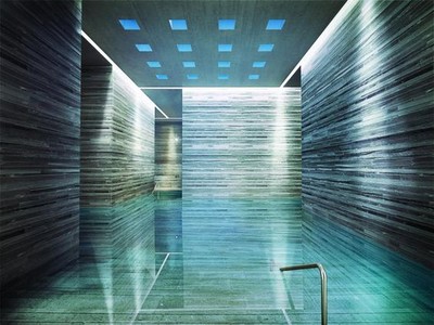

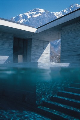

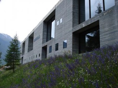

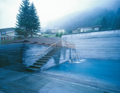

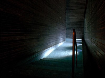

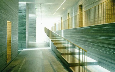

Previous in Blog: Guess the Architecture! for 3/28/2017   Next in Blog: Guess the Architecture! for 4/11/2017
8 comments
Guess the Architecture! for 4/4/2017
Posted April 04, 2017 2:00 PM
Does anyone recognize this building?
As I was drawing it, the texture reminded me of the Guess the Architecture for 11/22/2016. Perhaps one inspired that aspect in the other?
Re: Guess the Architecture! for 4/4/2017
04/04/2017 4:29 PM
Is there much more to this building that's not in the sketch?
Re: Guess the Architecture! for 4/4/2017
04/04/2017 8:11 PM
Stumped me. But that's not very hard to do.
It has many of the features of a Peter Barber design, but I'm not finding any matches.
Re: Guess the Architecture! for 4/4/2017
04/05/2017 8:27 AM
Just the corner of the building, which has five of the small upper windows and three of the slightly larger bottom windows.
Re: Guess the Architecture! for 4/4/2017
04/05/2017 10:01 AM
Thanks, not that it will help much, this one is another tough one.
Re: Guess the Architecture! for 4/4/2017
04/05/2017 9:15 PM
Looks like any of those single family dwellings in any big city, often affectionately known as, " The Projects ".
Location: Maine, USA
Posts: 2168
Re: Guess the Architecture! for 4/4/2017
04/06/2017 11:14 AM
I my first guess was Frank Lloyd Wright, but I have nothing to back that up!
Re: Guess the Architecture! for 4/4/2017
04/10/2017 11:20 AM
This week’s building was the Therme Vals by Peter Zumthor—a fairly well known building, with a less recognizable side. This structure is built on the only thermal springs in the Graubünden Canton in Switzerland, and it functions as a hotel and spa. According to the architect, “the idea was to create a form of cave or quarry like structure [while] working with the natural surroundings.” The baths can be found under a grass roof structure that is half buried into the hillside. The interesting texture can be attributed to “layer upon layer of locally quarried Valser Quarzite slabs,” and this stone “became the driving inspiration for the design, and is used with great dignity and respect."
Re: Guess the Architecture! for 4/4/2017
04/12/2017 7:02 PM
Oh, I reeeally like the plush(?) furnishings...
Brave Sir Robin (1); JPool (2); MaggieMc (2); MR. Guest (1); Tom_Consulting (1); tonyhemet (1)
Previous in Blog: Guess the Architecture! for 3/28/2017   Next in Blog: Guess the Architecture! for 4/11/2017
