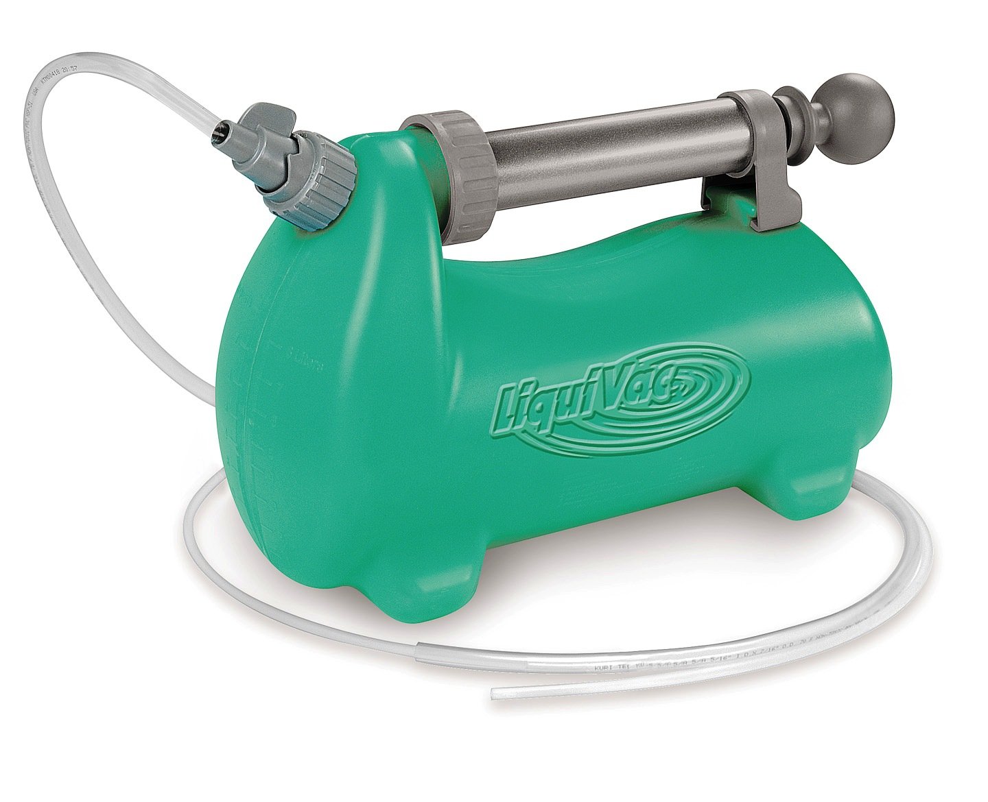

05/28/2015 11:14 AM
...or he could pump it out and store it, or dispose of it at his convenience...
http://www.amazon.com/America-2000-LiquiVac-Changing-System/dp/B0002AJR8E
...install some sort of dual filter bypass system....
